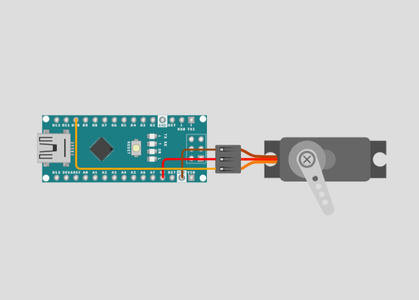

Step 1: Hardware Connections
Hardware Connections:
  1. Connect the servo's GND (Ground) wire to one of the GND pins on the Arduino Nano.
  2. Connect the servo's V+ (Power) wire to the 5V pin on the Arduino Nano.
  3. Connect the servo's PWM (Signal) wire to digital pin 10 (D10) on the Arduino Nano.
