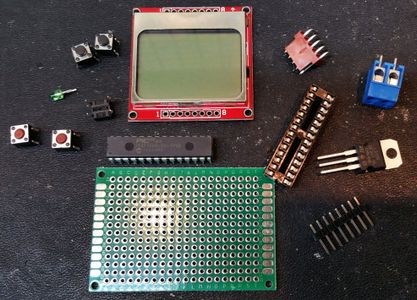

Step 1: Servo Tester Parts
The LCD I picked is easy to interface and is rather common. They can be found on Ebay - http://ebay.com by searching for "84x48 Nokia LCD Module Blue Backlight Adapter PCB Nokia 5110 LCD For Arduino" or even just 5110. They are about $3.
The microcontroller is the CGMICROMITE is from http://www.circuitgizmos.com/products/cgmicromite2/cgmicromite2.shtml for $6.50. This chip has an advanced BASIC interpreter and on-board editor. It is a 28 pin DIP chip, so it is very easy to prototype with. Perfect for this project.
Other parts include a Prototype Circuit Board, seven small pushbuttons, a 28 pin socket, an 8 pin strip (for LCD), a right-angle 5 pin strip (for servo), a right angle 3 pin strip (serial interface for programming), a two-pin screw terminal, a 3.3V regulator (for the microcontroller), a couple of caps, and a couple of resistors.
The picture shows most of the parts.

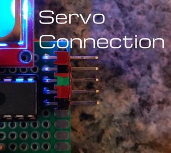

Step 2: Servo Connection
One thing I wanted to be sure to do was use a 5 pin servo connection that has two servo negative and two servo positive connections. Arranged as they are in the photo above you can connect the 3 pin servo connector to the 5 pin header no matter how the connections are arranged on the 3 pin servo plug.
For example some servo connectors have servo negative in the middle, some have signal there. The one I have pictured that I tested has servo positive in the middle.

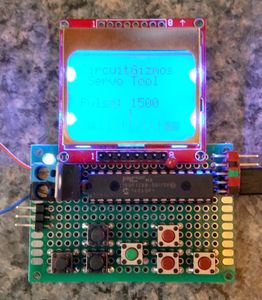

Step 4: LCD and Button Layout
The LCD is placed at the top of the PCB and the buttons are arranged in the same pattern that they are shown on the schematic.
The center button, painted green, centers the servo by setting the servo control pulse to 1500 microseconds. The top black and red buttons swing the servo to one side or another with commands of 800 and 2200 microseconds respectively.
The lower black buttons reduce the pulse by 10 or 100. The lower red buttons increase the pulse by 10 or 100.

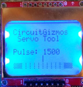

The LCD displays the pulse width numerically. At center position that is 1500 microseconds.
There is a graphic indication of the servo position at the bottom part of the display. There are 100 microsecond tic marks and above that a pointer that moves right as the pulse width decreases and left as it increases.

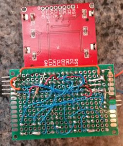

Step 5: Wiring/Soldering
Point-to-point wiring was used. That is a 26 guage wire going from point to point. On the back you can see the resistor that was picked (470 ohm) rather than the 1k on the schematic for LED brightness.
The other resistor is the 10k that is needed to pull the serial data in line to ground.
