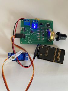

The tool I will be building is a servo testing PCB. This simple circuit allows you to connect up the servo you've had in your parts bin for years and simply check whether it still works before you proceed with your project. It means you can be certain the servo works before you blame any dodgy code or wiring.

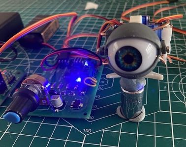

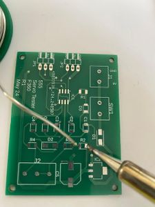

Step 3: Soldering the PCB

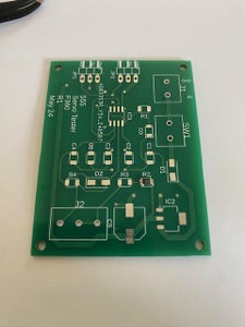

I designed the PCB to mostly use Surface Mount components. I did this because I feel that over the next few years surface mount components will mostly be used in electronics, even hobby electronics. Surface mount components are generally preferred over through-hole components because they allow for smaller, more compact designs, higher component density, and automated assembly. Automated assembly might not seem important for hobby electronics but can be useful if you making many PCBs and is a serviced that can be added when you are having your PCB manufactured.

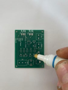

I purposefully used larger 1206 components to make it easier for hand soldering, here's how I hand solder SMD components:
  1. Clean the solder pads for the component with a flux pen, or similar.
  2. Apply some Solder to one of the pads.
  3. Place the component next to the pad and hold with tweezers.
  4. Heat the solder you have already applied and push the component connection into the solder with the tweezers.
  5. Apply solder to the unsoldered pads.
You can use this method for all of the components, you just need to be careful with the smaller components such as the 555 IC. You should inspect the connections after completion to ensure there is no bridging between connections. You can remove bridging with solder wick.

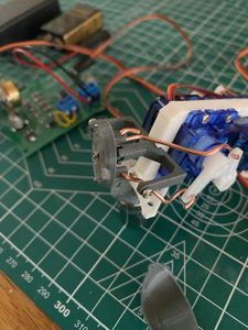

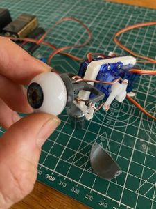

Step 4: Assembling the Animatronic Eye
I decided to use an animatronic eye for to demonstrate the servo testing tool because the are fun and I've always wanted to build one.

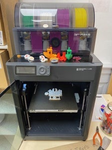

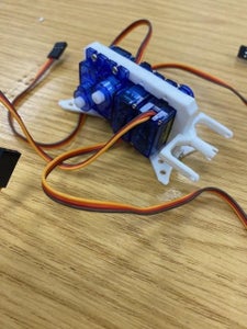

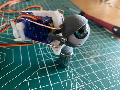

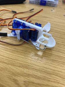

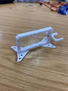

I didn't design this eye myself as the aim of the project was to build a PCB to test Servo's but I needed something to test it out on. I purchased the plans on Etsy and then 3D printed them at my Hackspace (Norwich Hackspace, UK) using our new Bambu 3D printer. It was all held together by 2mm screws and I assembled the Eye as follows:
  1. Mount the two feet to the frame.
  2. Mount the Pivot to the frame.
  3. Mount the four Servos to the frame.
  4. Mount the eye holder to the pivot.

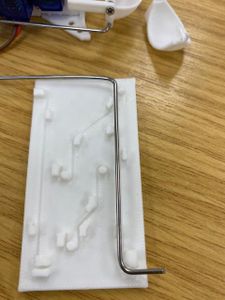

  5. Bend the linkage wires to shape with the wire jig.
  6. Mount the Servo horns.

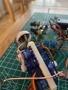

  7. Connect the two eye holder linkages.

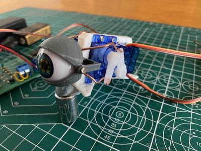

  8. Fit the eye ball to the eye ball holder.
  9. Fit the two eye lids.
  10. Connect the two eye lid linkages.
  11. Connect the Servo's to the Servo Test PCB.
Note: On most hobby servo's the Red wire is 5 Volts, The Brown Wire is Ground (0 Volts) and the yellow wire is the controls signal (the PWM signal).
You are now ready to try your servo controlled animatronic eye out. Be careful at first as you might need to adjust the angle of the servo horn to the correct middle position.
