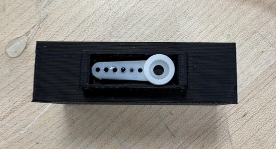

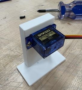

The delivery mechanism works by using a servo that is mounted in a 3d designed & printed mount. There is a chute that the food can be placed into. The chute has a space that you can connect or glue one of the one sided arms that comes with many servo kits. It is designed this way so that an easily replaceable part and easily findable part is used as the connector to the servo, since they are designed to fit snugly with the gearing on the servo itself.
Both the chute and the stand are 3d printed. The only specifications that are out of the control of the builder is the connection from the chute to the servo itself, which is standardized to the plastic arms. However, if a better connection exists, feel free to modify the .stl files as such.

- Print the motor holder and food holder on a 3D printer
- Super glue a motor leg to the food holder
- Screw in the servo to the servo holder
- Cut the female holders off of the end of the servo and solder wires to the stripped ends
- Connect the data wire to GP15 and the power and ground to 5v and ground respectively

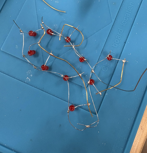

The decorative fish light is a small ambient addition with the purpose of entertaining and indicating status to the user. We 3D printed a template for the positioning of lights with a small divot added for visual cohesion. We ran the lights in parallel to allow for singular indexing of the lights.
Steps for construction:
- Print the fish model on a 3D printer

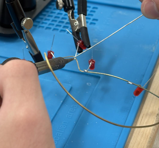

- Grab 10 led lights and separate the legs 90º from one another
- Solder each of the positive legs to a shared brass wire
- Solder each of the negative legs to a shared brass wire
- Connect the positive ends to GP18 and the negative ends to GP14
