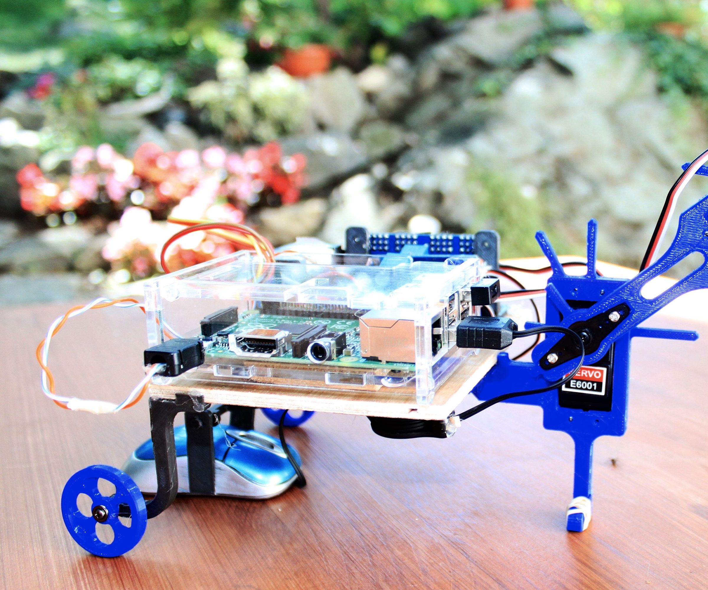

For my projects I use several standard servos which are controlled by the ADAFRUIT PWM SERVO DRIVER which in turn is controlled by a python script running on Raspberry Pi.
Each time I re/assemble a horn on a servo I need to re-adjust the 'zero angle'. If I replace a servo, it may have different conversion of PWM to angle position. It took so much of my time to adjust those parameters with each change I decided to write simple Tkinter GUI which would allow to set, verify, and save:
