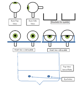

The first thing I did was come up with the design for the eyes and eyelids on a word processing program (I converted it to .png) and then cut out a piece of mdf to hold the eye and the servos. I ended up having to cut out another piece of MDF to get the eyes closer to the inside of the mask.

I used 40mm ping pong balls with wooden dowels that go through the top so the eyes sit on board.
A few more dowels are glued into the back of the ping pong balls so the eyes can move left and right. Two large paper clips were straightened out to assist with connecting the dowels to the servo.
Before I attached the eyes to the board, I attached "U" brackets which the eyelids are connected to the mdf. A few more large paper clips were used as connectors between the eyelids and the servo. At first I used hot glue to attach the eye lid servo to the mdf, but I decided to make it more secure and used vertical servo mounts.
A small square piece of wood sits just in between the "U" brackets and a pop sickle stick is attached to the little piece of wood to keep the eyes from rolling back, but still allowing the eyes to move.

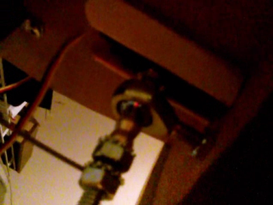

To make the face move up and down I used a 1/4 rod end and attached that to a piece of mdf. The mdf was attached to the main board and a 1/4 threaded rod was inserted into the rod end. Note: The first picture was not the final board that was used. The picture is to show how the parts were connected up.
1/4" compression sleeves were placed above and below the rod end and a nylon locking nut was attached to the top of the threaded rod.
A 1/4" locking nut was added under the bottom compression sleeve and a heavy gauge rod (it is the metal part of an irrigation flag) was attached and used as an arm for the servo. Another 1/4" locking nut was used to keep the arm in place and an additional vertical servo mount was used to hold the servo in place.
In order to keep the face from wobbling side to side, a track was added which was made using a tongue depressor cut in half and hot glued to either side of the nylon locking nut.
