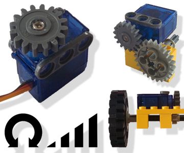

Introduction: Servo-motor Converted to Motor (with Speed & Direction Control)
The purpose of this Instructable is to convert a servo-motor 9g to a motor while conserving the servo-driver to control the rotary speed and direction. No electronic modification is required for this Instructable. No need of hot soldering iron!
The last step is optional. It is dedicated to Lego adaptation in continuity with my main project (see Servo-motor adapted to Lego for more explanations).

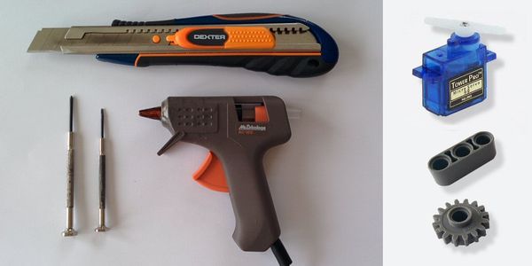

Materials:
  • cutter
  • hot-melt glue applicator
  • precision screwdriver (adapted to servo-motor screws)
  • precision flat screwdriver (1,2 to 1,5 mm wide)
Components:
  • servo-motor 9g
  • Lego gear 16 tooth with Clutch*
  • Lego liftarm 1 x 3 Thick (dark bluish gray)*
*required only for Lego adaptation (see optional last step)
The Lego components can be easily purchased from Lego parts suppliers such as ToyPro.

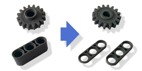

Step 4: Adapt the Motor for Lego
The gear must be cut as seen on photos, then refer to the following Instructable : Servo-motor adapted to Lego (note that the last adaptation in the Step 2 is not required in this case).
