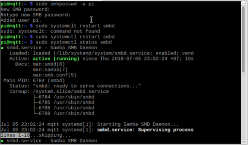

      Step 4: Install Samba to Share Folder
      This step will walk you through some basic setup to have a shared folder hosted on Raspberry Pi that can be accessed to from other computers.
      First, install samba, a program to share and manage sharing folder across the network:
      sudo apt-get install samba
      make a shared folder
      mkdir ~/Desktop/sambaShare
      modify the configuration file for the samba by:
      sudo samba /etc/samba/smb.conf
      add the following lines to the end of the file:
      [sambaShare]<br>  comment = share Folder on Research RPI
        path = /home/pi/Desktop/sambaShare
        browseable = yes
        read only = no
        writable = yes
        public = yes
        create mask = 0777
        rectory mask = 0777
        guest ok = yes
      If you have the problem with writing on windows, force it by adding this line to the end of the file: force user = pi
      On Linux, you may need to use the root user (I will post the problem once I found out)
      Next, add a user to samba and create a password as well:
      sudo smbpasswd -a pi
      then enter a password for the samba (can be the same or different than the password for pi user on the system)
      test if the config file is okay
      testparm
      press Ctrl+X to save, and then restart samba service by:
      sudo systemctl restart smbd
