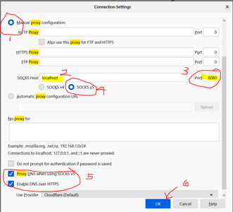

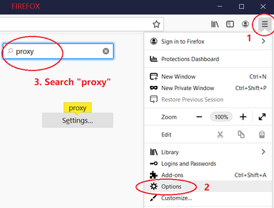

Step 4: Configure SOCKS in Firefox
Open the "PROXY" setting in Firefox, enable manual proxy configuration as follow:
a. SOCKS Host: localhost
b. Port: 8080 (the same lucky number in step 2)
c. Select "SOCKS v5"
d. Tick "Proxy DNS when using SOCK v5"
e. Tick "Enable DNS over HTTPS"
And finally click "OK", now we are ready to go :-)
