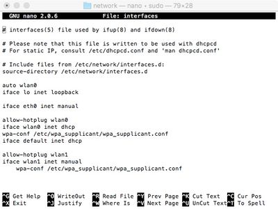

There are two files that need to be edited; network interfaces and wpa_supplicant.
Start by changing the directory to the 'network' folder on the SD card by typing:
cd /Volumes/root/etc/network
Then open the 'interfaces' file in the nano editor by typing:
sudo nano interfaces
Terminal will probably ask for the login you use for your computer (the one you enter when you boot up).
Then you will see the contents of the 'interfaces' file.
Make sure the first line says auto wlan0 and that there is a line that says allow-hotplug wlan0 and a reference to the wpa_supplicant file as in the image above.

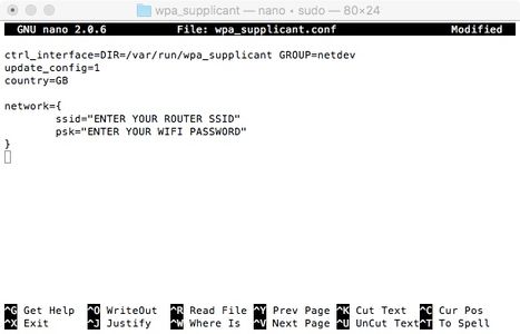

sudo nano wpa_supplicant.conf
Enter your password if requested and then you will see the contents of the file.
Change the SSID and password to suit your Wifi network and then type Ctrl X to exit and save the file.

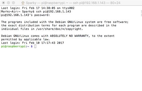

Now you can eject your SD card and insert it into the Raspberry Pi Zero along with your Wifi dongle and power cord and then use the Terminal programme to remotely access over ssh. Make sure your computer is on the same Wifi network when you attempt this.
You can find out details on using ssh here.
Once the connection is made you will see a window like the image above and you're good to go.
