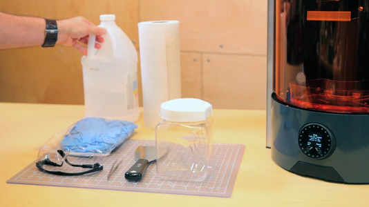

Before you start printing, you'll also want to set up your finishing station, in the vicinity of your printer. Proceed to the next step for guidance in doing this...
Step 1: Set Up Your Finishing Station
This video shows you how to set up your finishing station. Be sure to use a sturdy table. The fluid in the large white bottle is isopropyl alcohol, which is commonly available in pharmacies.
