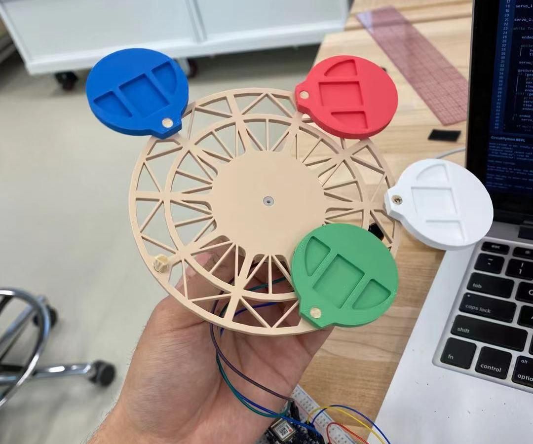

Step 4: 3D Printing the Case
If you already have a case, great! Otherwise, I've attached a link to the 3D print I used for this project and also uploaded the one I used for the project. I edited mine slightly to fit the Raspberry Pi.
Make sure to print the project with maximal support. There are little hinges in the design, which would cause the print to fail if there's no support.
Link to original 3D print: https://pinshape.com/items/662-3d-printed-elephant
Step 5: Assemble
Assembly should be relatively easy. I used two pieces of double sided tape to tape down the Raspberry Pi and the Distance Sensor.
