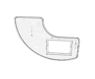

Step 4: Break Out the Drill
If you have gone to this much work, it is worth the time to drill a hole in the back panel so the plug can be easily accessed. I have included a template marking the hole. My initial attempt was a little off, but this one should be spot on. A 1/2 inch hole was a little tight, but worked. In the future I would tape off the back of the panel to avoid marring the paint on the panel. After connecting the USB cable the panel can be put back on.
