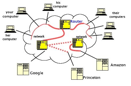

The “cloud” has many advantages in terms of accessing your data from anywhere you’ve got Internet access, but it’s got lots of limitations – in particular if your Internet connection is temporarily unavailable and personal privacy concerns. I prefer my own “microcloud” – a privately accessible USB drive which all of the computers, smartphones, and other devices on my network can access and share data. It’s easy to set up, inexpensive, inter-platform, and can be expanded as your needs change over time.
If you link to this instructable from another website, please include a link to the Neat Information website.
This article is copyrighted and may not be reproduced without permission.

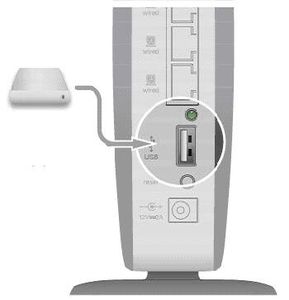

Step 2: Setup
Hook up the router to your network, like any other router. It goes without saying, but I’m going to say it anyway – not password protecting your network with at least WPA2 protection is as stupid as leaving your front door unlocked when you’re not at home.
Your USB drive will plug into the jack on the back of the router.
The Belkin Share N300 router has the network name preset to Workgroup and there doesn’t appear to be an easy way to change this name. Workgroup is the default name for the professional versions of Windows. MS Home is the default name for home versions of Windows but there’s nothing to stop you from changing the network of each of the computers running home versions of Windows to Workgroup. For non-Windows computers (Linux, Macintosh, smartphones) just set the name of your network to Workgroup.

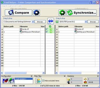

Step 4: Syncing Everything Up
The open source utility “FreeFilesSync” is configured to update the data folder on my primary computer’s hard drive with the USB stick on the microcloud. In theory I could set it up to automatically update files as they’re changed. It isn’t worth that much effort at the present so I manually run FreeFilesSync at the end of each day. As a side-benefit syncing my data folder ensures that I’ve got an additional backup of my most critical information besides my normal hard drive backups.
If I needed access to the entire microcloud data folder from any of my other computers I use FreeFilesSync. On computers that only need occasional access to the microcloud I manually navigate through the network. If I wanted to I could make a shortcut of the microcloud drive on any computer or map it as a network drive.
