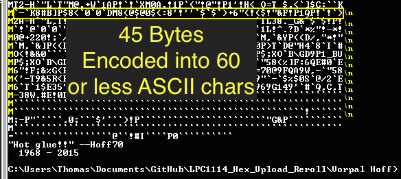

UUE stores and sends data in lines. A line of UUE data consist of a start character, which represents how many bytes have been encoded in the line (not how many UUE characters are in the line) by using a 6-bit number stored as an ASCII char. The line of UUE data ends with a new line character (i.e., '\n'). Lastly, a UUE line is limited to 45 bytes of data. This means, the maximum amount of data characters in on line of UUE should be no more than 60. Or, 62, if you count the start character and the end character.

- 17-25: I deal with the start character of the first line. I do this by checking if hex data we were handed is more than the UUE line limit, 45 bytes. If it is, I place an M as the start character (45 + 32 = 77 = ASCII M). If the data we've been handed is less than 45 bytes, let's calculate the start character. We take 65 bits of the 8-bit number representing how many bytes are here, then add 32, this will give us our start character.
- 30-96: This is the main loop where the work is done. We loop through all the hexadecimal data provided us, encoding as we go.
- 33-48: The loop here deals with 3 bytes of data at a time. It also checks to see if we have less than 3 bytes left, if so, it pads the remaining space with 0 (null).
- 47: This index is used in combination with the if statement found one lines 82-90. It is in essence repeating the beginning if statement where we determined what the start character for this line will be.
- 51-54: This is where the magic happens. Here, we are turning the 3 bytes of 8 bits, into 4 bytes of 6 bits. We store the resulting bits in an 8-bit variable. But remember, we can put 6 bit data in a 8 bit jar, as long as we remember to be careful how we place the bits.
- 56-69: The resulting 6-bit characters are checked to see if they are a space character (0x20), if they are, we turn them into a grave ' ' ' character (0x60). If they are not a space, we add 32 to the decimal value (' ' = 32 in decimal), this completes the encoding process.72: We calculate how many data bytes are left, in preparation for calculating the next line's start character.
- 74-96: This loop serves two purposes. One, to place a new-line character ('\n') at the end of our last encoded line. Two, to calculate and load the next line's start character.
- 96: When we've reached the end of our data, we place a new-line character to mark the end.
- 112: We return the number of ASCII characters used to represent our encoded data.
