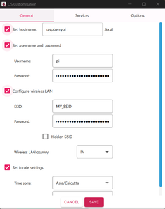

  1. I always choose Raspberry Pi OS Lite (64-bit) - no desktop environment means more resources for our containers
  2. During the imaging process with the Raspberry Pi Imager, make sure to:
  3. Enable SSH in the advanced options (crucial for headless access)
  4. Set up my username and password
  5. Configure my WiFi credentials
  6. Set up my locale settings
I prefer the 64-bit Lite version because:
  1. It gives me better performance with containerized applications
  2. Uses less memory without the desktop environment
  3. Works perfectly with Docker and ROS 2 containers
  4. Feels more like a proper server setup
