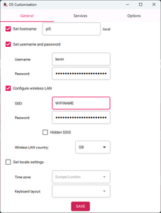

Step 1: Installing Raspberry Pi OS Onto MicroSD Card

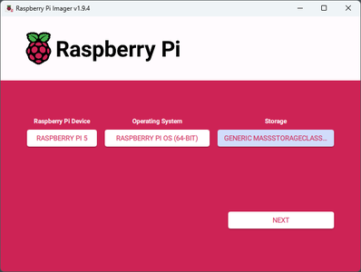

The Raspberry Pi imager program is the standard way to write an o/s image onto a microSD card from another computer. This can then be inserted into the (powered-off) Raspberry Pi.
  1. Insert the microSD card into the computer via an adapter if required.
  2. Select the appropriate Raspberry Pi hardware.
  3. Select the Raspberry Pi OS (64bit) (a port of Debian Bookwork with the Raspberry Pi Desktop (Recommended) (Raspberry Pi 3 and above are 64bit).
  4. Select device for the microSD card.

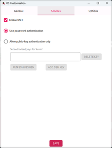

  5. Click NEXT and then EDIT SETTINGS for setup WiFi and to ensure ssh is enabled for remote access to a headless (no monitor attached) Raspberry Pi.
  6. Click on WRITE.
  7. Wait for it to finish.

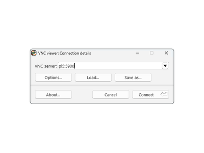

Step 4: Downloading a VNC Client - TigerVNC
A VNC client can be used for a graphical login to the Raspberry Pi over the network.
TigerVNC is a "high-performance, platform-neutral implementation of VNC (Virtual Network Computing), a client/server application that allows users to launch and interact with graphical applications on remote machines" based originally on TightVNC.
The GitHub releases page points to SourceForge for the actual downloads. There are many files to choose from, the naming scheme is explained at the bottom of the page, care is needed to select the correct one as they all sound very similar. The version 1.15.0 client for Windows (64 bit) is https://sourceforge.net/projects/tigervnc/files/stable/1.15.0/tigervnc64-1.15.0.exe/download.

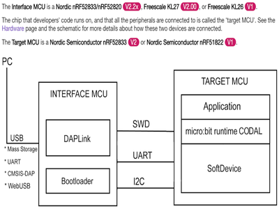

This is a very simple demonstration of a breakpoint and single-stepping. There are many panes on the left (VARIABLES, WATCH, CALL STACK, BREAKPOINTS, CORTEX LIVE WATCH, XPERIPHERALS) showing more functionality available.
The variable brightness LED matrix display provided by CODAL for the micro:bit is implemented with interrupts. The video demonstrates how interrupts are affected when the heart image is displayed and the program pauses - this must also pause interrupt servicing preventing the display image from being maintained correctly. This form of audio must also use hardware features and/or interrupts to produce the complete sound effect.
While breakpoints implemented in hardware can have no impact on the behaviour of the processor, many debugging features or actions will cause a change in timing which may unfortunately change the behaviour of the code.

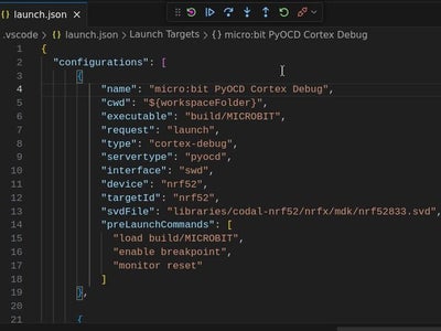

Step 13: A Look at the Debug Configuration Files
The microbit-v2-samples repository includes a .vscode directory. This conveniently includes a launch.json file with three entries under configurations, the first one is the pyOCD one, shown below and above as a screenshot from Visual Studio Code.
"configurations": [
"name": "micro:bit PyOCD Cortex Debug",
"cwd": "${workspaceFolder}",
"executable": "build/MICROBIT",
"request": "launch",
"type": "cortex-debug",
"servertype": "pyocd",
"interface": "swd",
"device": "nrf52",
"targetId": "nrf52",
"svdFile": "libraries/codal-nrf52/nrfx/mdk/nrf52833.svd",
"preLaunchCommands": [
"load build/MICROBIT",
"enable breakpoint",
"monitor reset"
The executable here is not the hex file, it's the same code in an elf format executable.
This also sets the System View Description (SVD) file which provides information about the memory-mapped hardware for the Nordic nRF52833's internal peripherals.
Step 14: A Look at Hardware Needed (or Not Needed)
A microcontroller can be debugged via an SWD or JTAG interface. This needs to somehow be connected to a remote computer for remote debugging. This might be via a hardware probe, some low-end examples are listed below.
  1. Raspberry Pi Debug Probe (a Pi Pico can also be used with debugcode firmware)
  2. STLINK-V3MINIE
  3. J-Link EDU Mini (for for non-profit educational purposes only)
It could also be via an onboard probe which may just be another microcontroller acting as a USB interface and running some specialist firmware, some examples for hobbyist boards are listed below.
  1. BBC micro:bit (all of these run DAPLink firmware)
  2. V1: Freescale KL26
  3. V2.00: Freescale KL27
  4. V2.2x: Nordic nRF52820 (or nRF52833)
  5. Arduino UNO R4 WiFi: ESP32-S3
This explains how the micro:bit V2.21 used in this article can be debugged without any additional hardware.
