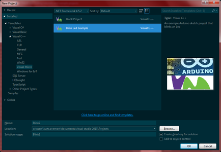

Now on to opening a new sketch, when you either select the menu option FILE>NEW>ARDUINO PROJECT or Click on the NEW button then the TEMPLATES>VISUAL C++>VISUAL MICRO, you will presented with Picture 1
This allows for 2 options, one is a Blank Sketch and the other is a Blink sketch. I choose a Blink sketch for this Demo. On the Right hand side of VS 2015 you should see something similar to Picture 2.
