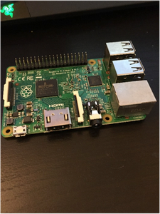

Step 1: Purchase Raspberry Pi and Accessories
Purchase a Raspberry Pi (recommended Model 3), a MicroSD Card (at least 32 GB), a HDMI Cable, Ethernet cable (if necessary), and Micro USB cable with wall port. You will also need a Monitor or First Party Touch display and keyboard and mouse.

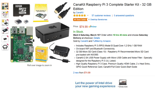

Step 2: Purchase Raspberry Pi Starter Kit
If one does not have any of the required equipment, Amazon sells a Raspberry Pi starter kit that comes with everything needed to get started, which can be purchased at the link below.
http://www.amazon.com/CanaKit-Raspberry-Complete-Starter-Kit/dp/B01C6Q2GSY/ref=sr_1_2?ie=UTF8&qid=1458704310&sr=8-2&keywords=raspberry+pi+b+starter+kit

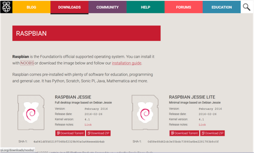

Step 3: Download a UNIX OS
A Raspberry Pi is designed to work with a UNIX operating system; until one is installed, the device can't do anything. There are a variety of free Linux distributions (Linux-based Operating Systems) that one can use, and a tech savvy person may choose to use their preferred distribution. We will show how to use Raspbian, which is a Linux distribution specifically designed for use with a Raspberry Pi. One may choose to install Raspbian manually, in which case one may download Raspbian directly from the Raspberry Pi website, at the link below.
https://www.raspberrypi.org/downloads/raspbian/

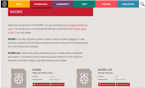

Step 4: Install NOOBS
For our demonstration, we will be using a program called NOOBS, which contains Raspbian and an installer wizard to make the installation process as easy as possible. One should install NOOBS onto an SD card and plug it into the Raspberry Pi; in this case, the installation will be as simple as following onscreen instructions.
https://www.raspberrypi.org/downloads/noobs/

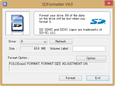

Step 5: Format Your SD Card
Format the SD card and wipe it clean use the SD Association's Formatting Tool, which can be downloaded from sdcard.org and follow the download instructions to successfully install the program. Insert the SD card into your computer’s card reader. Use the SD formatter on your computer and select the drive formatter. You will need to set "FORMAT SIZE ADJUSTMENT" option to "ON" in the "Options" menu to ensure that the entire SD card volume is formatted.

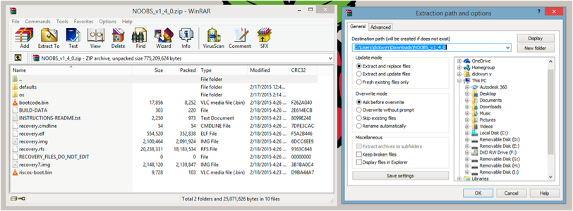

Step 6: Transfer Files From NOOBS to Your SD Card
Once your SD card has been formatted,
drag all the files in the extracted NOOBS folder and drop them onto the SD card drive. The files will then be transferred to your SD card. When this process has finished, remove the SD card from your computer.

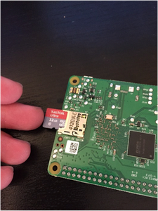

Step 7: Plug the MicroSD and SD Card Into Your Raspberry Pi
Insert the microSD card into the bottom of the Pi in the SD Card slot.
There’s only one direction it can be plugged in.
Caution: If you didn’t purchase a case, hold your Raspberry Pi from the sides at all times to avoid risk of damaging the device.

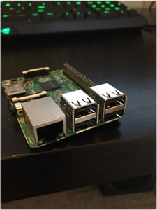

Step 8: Plug in Other Necessary Devices
The Model 3 has WiFi built in, so an Ethernet cable is not completely necessary.
The Model 3 also has Bluetooth, so you can use compatible keyboards and mice if applicable.
NOTE: The microUSB cable should be plugged in last. The Raspberry Pi has no power button, so it will start automatically

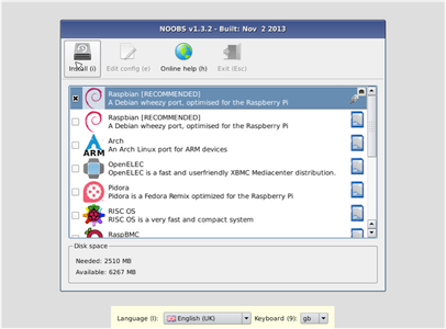

Step 9: Install Your Operating System
Once the Raspberry Pi boots up, a pop-up window will appear that shows the different installable operating systems.
The Raspberry Pi Foundation suggests installing Raspbian, so check the box next to "Raspbian" and click "Install".
Installation will start immediately, and it may take up to 20 minutes. Afterwards, click "OK" and the system will reboot and the command line will open.

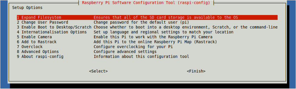

Step 11: Open the Raspberry Pi Configuration Tool
Enter "sudo raspi-config" into the command line to open "raspi-config", the Raspberry Pi configuration tool.
Step 12: Up to You!
From the "raspi-config" menu users can set and reset all Raspberry Pi's settings.
And that is it! Clicking “Finish” will exit the setup and boot into the Raspberry Pi!
