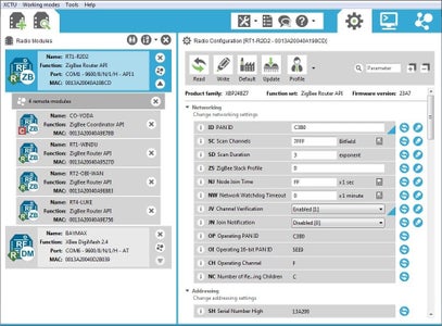

Step 2: Configuring XBee Modules Using XCTU Software
Basically, the XBee module can be configured as Coordinator, Router, or End device. To make it work as we desire, first, we have to configure them using XCTU software. You can download and install the XCTU software using the given link.

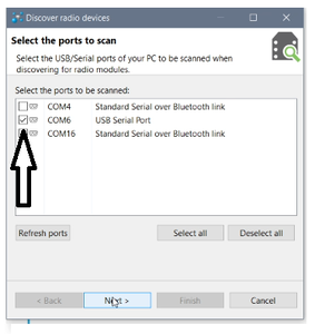

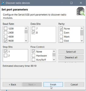

Step 2: Select the COM port to which the XBee module is connected and click on “Next”.
Step 10:
Step 3: Keep the default settings and click on “Finish”.

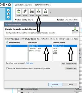

Step 6: To update the firmware, click on “Update”, select “802.15.4 TH” in the Function set and select the newest firmware in the Firmware version and click on update. After this, a pop-up window will appear. Click on YES.

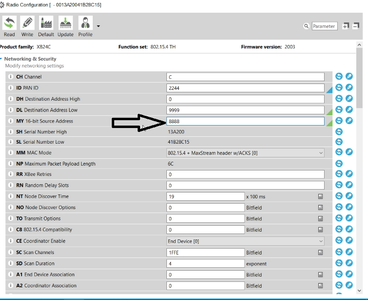

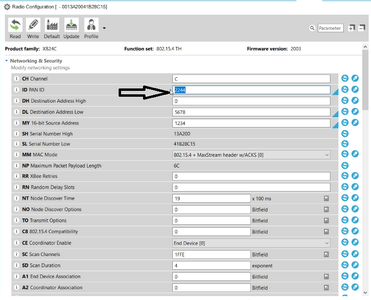

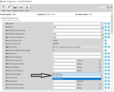

Step 7: Enter any 4 digits as PAN ID. PAN ID is a personal area network (PANs) identifier. Each network must be given a unique ID. Make sure that for both the XBee modules, the same PAN ID is entered. This indicates that both the XBee modules are in the same network.
Step 15:

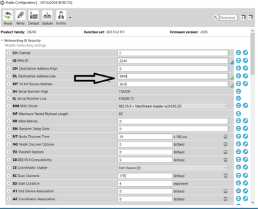

Step 8: Give any 4 digits for the Destination Address. This same number must be entered as Source Address for the other XBee module.
Step 16:
Step 9: Give any 4 digits for the Source Address. This same number must be entered as the Destination Address for the other XBee module.
Step 17:
Step 10: Set one device as “Coordinate [1]” and the other device as “End Device [0]”.
Step 18:
Step 11: Now, click on Write in the top bar. After that is successful, the Symbol changes from “E” to “C” (End Device to Coordinator, as we have set. For the other XBee module, it should be “E”).

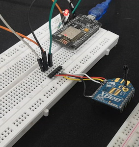

Step 20: Soldering XBee Pins to Arduino and NodeMCU
The pins of the XBee module are not compatible with breadboards. Hence, solder 4 wires from XBee module pins to header pins and use that to connect to the breadboard as shown in the figure below. Alternatively, you can also use female to male header connector wires, if you want to avoid soldering works.
