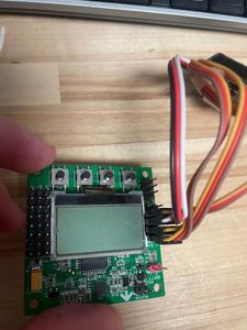

Step 1: Understanding the KK2.1.5 Flight Controller Layout
Before you begin, familiarize yourself with the layout of the KK2.1.5 flight controller. Here's what each part does:
Motor and Servo Ports: These are on the right side of the board, and they connect to your ESCs and servos. Depends on your motor layout which I explain below.
Receiver inputs: All of the left ports are going to be used for your data from your receiver to your transmitter.
Buttons: The controller has four main buttons – Enter, Up, Down, and Back. These allow you to navigate through the menus.
XT60 Plug: This is where you connect your LiPo battery to power the board. You will need a esc to power it through a motor port.

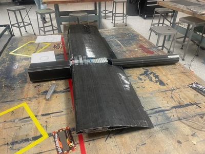

Step 2: Creating the Wing From Foam Board
Choose a frame design for a plane or glider I be going only over a glider here.
Designing the Airfoil:
Airfoil Shape: Choose a symmetrical airfoil if you want stability and ease of control. An asymmetrical airfoil can provide more lift but may require more adjustments during flight.
Marking and Cutting: Mark the foam board to the desired wing dimensions and use a straightedge to cut along your marks.
Folding: Fold the foam board at specific points to create the desired airfoil shape. Ensure both sides are symmetrical.
Assembling the Frame:
Once the wings are ready, connect them to the main frame of the glider.
Use lightweight materials for the frame to maintain overall weight. I Highly recommend foam board but you can use things like 3d printed materials ,balsa wood, foam, carbon fiber.

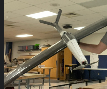

Step 3: Designing the Tail and Control Surfaces
In this build, we chose to use only a V-tail to save weight and reduce complexity:
V-Tail Design: The V-tail combines the functions of the rudder and elevator into two surfaces. It reduces the weight and drag but can be tricky to tune.
Control Surfaces: By using only the V-tail, you’ll need to adjust your control inputs carefully to ensure stable flight.
CAD Modeling: After deciding on your wing and tail design, create a CAD model to visualize and plan your build. Draw out each key component FIRST and ensure everything fits together smoothly.

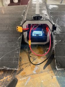

Now that your frame is ready, it’s time to set up your flight controller:
Connecting ESCs and Motors:
Plug the ESC 3-pin connectors into any of the motor/servo ports on the right side of the KK2.1.5 board.
Connect the XT60 plugs from the ESCs to the LiPo battery to power the board.
Initial Setup:
Power on the flight controller by connecting the LiPo battery. The home menu should appear.
Press the Enter button to access the menu.
Loading Motor Layout:
Navigate to Load Motor Layout using the Down button.
Select the motor layout that matches your glider setup. In this case, choose the V-tail configuration.
*You might need to flash motor layouts onto your board using a USB ISP.*
Accelerometer Calibration:
Go to ACC Calibration to calibrate the accelerometer. Ensure your glider is level during this step.
After calibration, return to the home menu and ensure there are no errors.

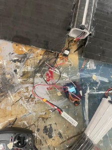

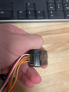

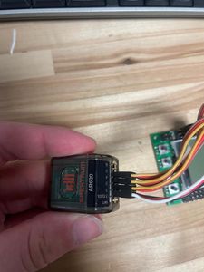

Step 6: Radio and Receiver Setup
Wiring Your Radio:
Each radio is different, so refer to your manual. Generally:
Throttle → Data 1
Aileron → Data 2
Elevator → Data 3
Rudder → Data 4
Receiver Setup:
For our setup, we used an additional receiver connected to the ESCs, which output directly to the servos controlling the V-tail surfaces. This bypasses the need for the flight controller in this loop, making it a simple setup.
