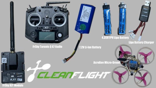

  • 1 FrSky Taranis Q X7 Radio
  • 1 AcroBee
  • 1 4.35V FPV Lipo battery
  • 1 Lipo battery charger
  • 1 FrSky XJT Module
  • 1 7.2V Li-Ion battery
  • Cleanflight Configurator
  • USB to MicroUSB cable

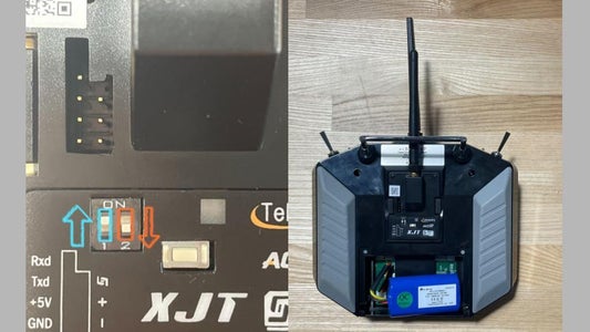

Step 1: Attaching the Telemetry Module and Battery to Radio
First, we need to set up the telemetry with the radio to make it easier to bind the drone. Before we attach the telemetry to the back of the radio, on the telemetry, Switch 1 should be turned on (moved to the top), and Switch 2 should be turned off (moved to the bottom).
Flip the FrSky Taranis Q X7 Radio over.
Next, insert the module into the top compartment. The cover can be squeezed off and placed to the side as it cannot be attached back on with the module connected.
We will also plug in the 7.2V Li-Ion battery in the bottom compartment. The cover can be slid off and back on once the battery is plugged into the bottom left socket.

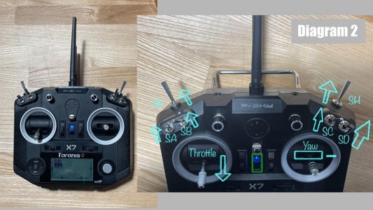

Press the power button. For some radios, it is necessary to hold the power button on the remote until the screen lights up, four dots are shown and a vibration is felt.
If a warning screen pops up, view Diagram 2 to see which switches must be moved and where. Press any button on the remote if a Failsafe warning screen pops up.

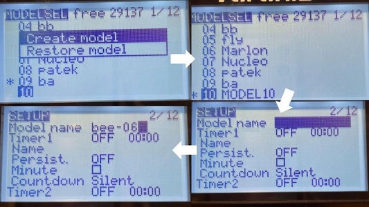

Step 3: Creating a New Channel for the Drone
Click the three lines between PAGE and EXIT on the radio's left side of the screen.
Twist the scroll on the right side of the screen to find an empty channel; select it by pressing the silver button on the scroll. Press the silver button again to select "Create Model". "MODEL##" will be seen in the channel you selected.
Press the PAGE button.
Make the Model Name correspond to your drone so that it is Bee-## or bee-##. (For example, if you have drone 06, make the Model Name bee-06. ) You can do this by pressing the silver button and scrolling to the letter, number, or symbol you want, then press the silver button again to move on to the next character. Once completed, press the EXIT button on the left side of the screen.

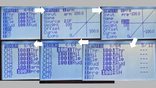

Step 5: Setting Up Arm and Pre-arm in the Radio
We need to set up an arm and pre-arm so the drone does not automatically go into flight once bound and the throttle is moved.
Press the PAGE button on the left side of the screen until you reach the INPUTS. Scroll down to 05 and press the silver button.
Press the silver button again and make the Input name "arm." You can do this by pressing the silver button and scrolling to the letter, number, or symbol you want, then press the silver button again to move on to the next character. Once completed, press the silver button.
Scroll down to Source and select it by pressing the silver button. Flip the SF switch up. Press the silver button again and then the EXIT button on the left side of the screen.
Scroll down to 06 and press the silver button.
Press the silver button again and make the Input name "pre." Once completed, press the silver button.
Scroll down to Source and select it by pressing the silver button. Flip the SH switch up. Press the silver button and then the EXIT button on the left side of the screen twice.
Press the Page button again to go to MIXER or MIXES.
Scroll to CH5 and press the silver button. Scroll down to Source. Press the silver button, wait a couple of seconds, and then press the button again so that it states "arm." Press the EXIT button. Repeat this with CH6, except it should state "pre." Press the EXIT button, then the three lines button, and finally the PAGE button.

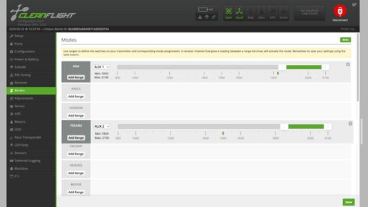

Step 6: Connecting to Cleanflight
First, go to Cleanflight and install the software. Open Cleanflight.
Next, connect the drone to your computer using a USB to micro-USB cable. Click Connect in Cleanflight.
Step 7: Setting Up Arm and Pre-Arm in the Drone
Once connected, go to Modes on the left side of the screen. Make the ARM range from 1800 to 2100 by sliding the green bar and change the AUX channel to AUX 1. Scroll down to PREARM. Make the range from 1800 to 2100 again and change the AUX channel to AUX 2. Click "Save" in the bottom right.
Go to Configuration on the left side. Click "Save and Reboot" in the bottom right. The drone should automatically disconnect from Cleanflight. Unplug the drone.
