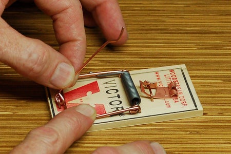

How To Set a Victor Mouse Trap
Setting a mouse trap is simple. You just need to have a steady hand and nerves of steel. It is not that bad but it does make your heart race holding a set mouse trap in your hands. Victor mouse traps, or copies of Victor mouse traps are probably the most widely used type of mouse trap in the world. This article teaches you how to set a Victor mouse trap.
Step 1: Remove the Mouse Trap Packaging
There is usually a staple holding the snap wire to the wood block. Remove the staple so the snap wire can be pulled back.
Step 2: Add Bait to the Trigger
The best mouse trap bait to use when setting Victor mouse traps is
peanut butter. Victor mouse traps need a bait that sticks to the trigger and does not just lay on it. Place enough peanut butter on the trigger so that it covers the trigger. Make sure it is stuck to the trigger so that it does not fall off when the mouse touches it. Make sure the peanut butter is only on the end of the trigger that is farthest from the mouse trap spring.
Step 3: Setting the Mouse Trap
Pull the snap wire back and lay the lock bar on top of the snap wire.
Lodge end of the lock bar under the hook on the trigger
Slowly relieve the hand pressure holding the snap wire down and let
the snap wire press upward on the lock bar which will press upward on the trigger. The baited end of the trigger will lift up locking the mousetrap in the set position.
If the lock bar slips off the trigger hook the trap will spring so be careful when removing pressure on the snap wire, keep your fingers away from the business end of the mouse trap at all times. (the business end is the end that has the bait on the trigger) It may take several tries to get the mouse trap set.
