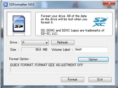

Now we will give the SD card a "reset" and clean it.
make sure that there is nothing on the SD card that you dont want to lose
open SDFormater and select the correct card ( check it is, otherwise bad things happen, I take no responsibility for what happens if it goes wrong). then press "Format".
when its done close the program and go to the next step

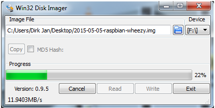

to write a OS to the SD card extract the .img file to a folder on your PC.
Then open Win32DIskImager and under "Image File" browse for the .img file you just extracted also under "device" select the right drive (check it is otherwis terrible things happen and again I take no responsibility for what happens) .
then press "Write" and it will be busy for a while, after its done close the program

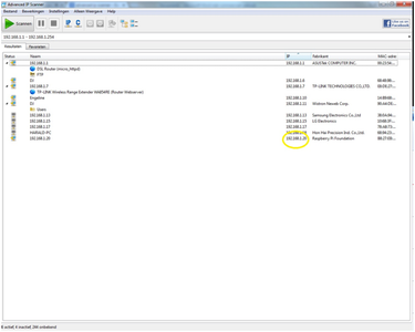

To make a SSH connection you first need to know its IP address, to figure this out I use advanced IP scanner.
open advanced IP scanner and press "scan" you should see a PC called "raspberry pi foundation" that's your RPi.
copy the IP address of the RPi.

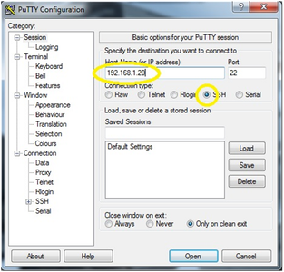

to make the SSH connection open PuTTY and paste the IP address under "Host Name (or IP address)" then select connection type "SSH" and press "open".
login as : pi
password is : raspberry
note: as you are typing the password is invincible but its there.
