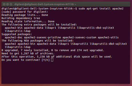

Step 1: Install Apache
Apache is a widely-used web server that is open-source and free. This is the "web server" portion of LAMP, but we still have to install the other portions of LAMP as well.
To install Apache, open a terminal (ctr+alt+t) and enter the command
sudo apt-get install apache2
Each install won't take very long on a reasonable internet connection. (Less than 5 minutes).

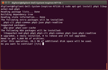

Step 3: Install PHP
Now we need to install the "P" of LAMP, or PHP. Other "P"s can include Perl or Python, but for our case, we are going to use PHP. PHP is a server-side scripting langauge for web-development, it can also be used for other types of programming if you prefer PHP over other programming languages.
Just like the other two installations, we go into a terminal to install. We are going to enter the command
sudo apt-get install php5 libapache2-mod-php5
to install PHP.

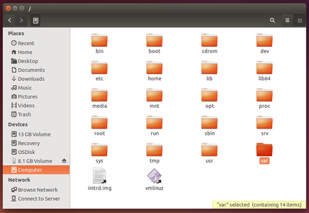

After you enter these, save your work and log-out, log back in and go to the "www" folder:
  1. Open up files.
  2. Click "Computer" in the devices section.
  3. Open up "var" (folders are sorted alphabetically, so should be near the end).
  4. Open "www".
  5. Right click inside "www" section, and the options "New folder" and "New Document" should be available!

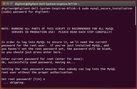

Step 5: MySQL Secure Installation
Before we can finish up everything we need to run the MySQL Secure installation.
In the terminal enter:
sudo mysql_secure_installation
Installation will ask sever questions, first we must enter the password (if you didn't enter a password just hit enter). The following are what options I chose, but of course you can pick others.
  1. Set root password? (No)
  2. Remove anonymous users? (Yes)
  3. Disallow root login remotely? (Yes)
  4. Remove test database and access to it? (Yes)
  5. Reload privilege tables now? (Yes)

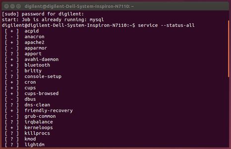

If you want to check the status of the "services", which includes more than just the items we've been working on, enter the command:
service --status-all
