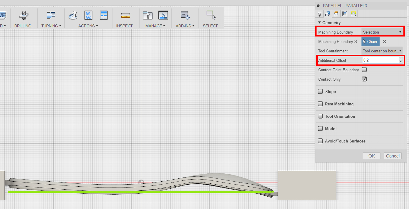

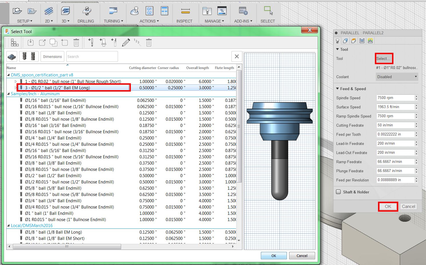

2) Click Select next to Tool.
3) Choose Tool #3, 1/2" ball (1/2" Ball EM Long). Click OK.
4) Click on the Geometry tab.
5) Next to Machining Boundary, choose Selection.
6) Carefully select the contour that runs around the edge of the spoon--the same one you chose in the Parallel toolpath in Setup 1, and as a boundary for the first Adaptive Clearing toolpath in Setup 2.
7) Verify that Tool Containment is set to Tool Center on Boundary, and add anAdditional Offset of 0.2.
This will allow the center of the tool to move slightly outside the boundary, to ensure that it reaches the entire fillet around the top edge.

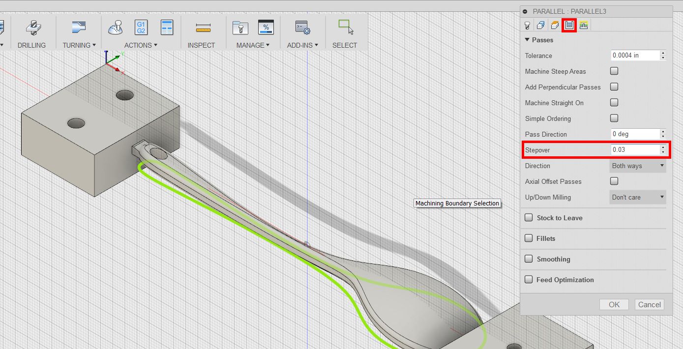

8) Click on the Passes tab.
9) Change the Stepover to 0.03.
This ensures that the parallel finishing on both sides will be visually consistent.

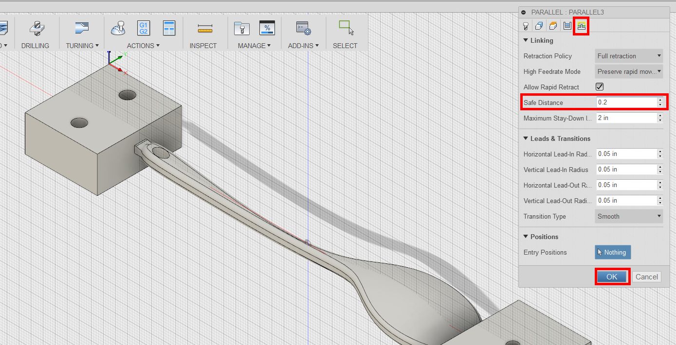

10) Click on the Linking tab.
11) Change the Safe Distance to 0.2.
12) Click OK to generate toolpath.

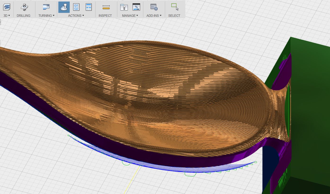

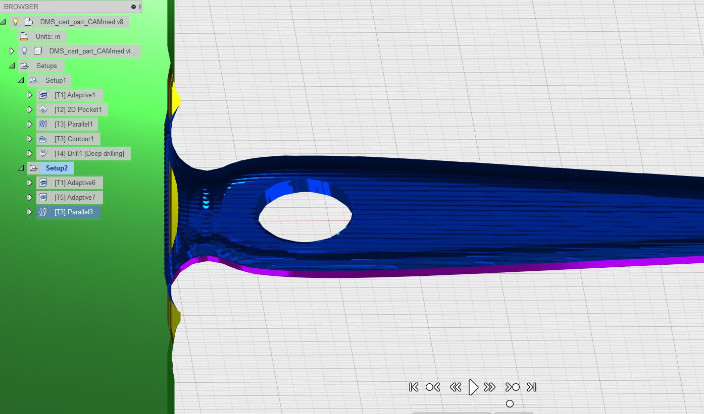

Step 1: Simulate!
1) Click Setups in the CAM Feature Tree.
2) Click Simulate in the Ribbon, and turn off the model visibility.

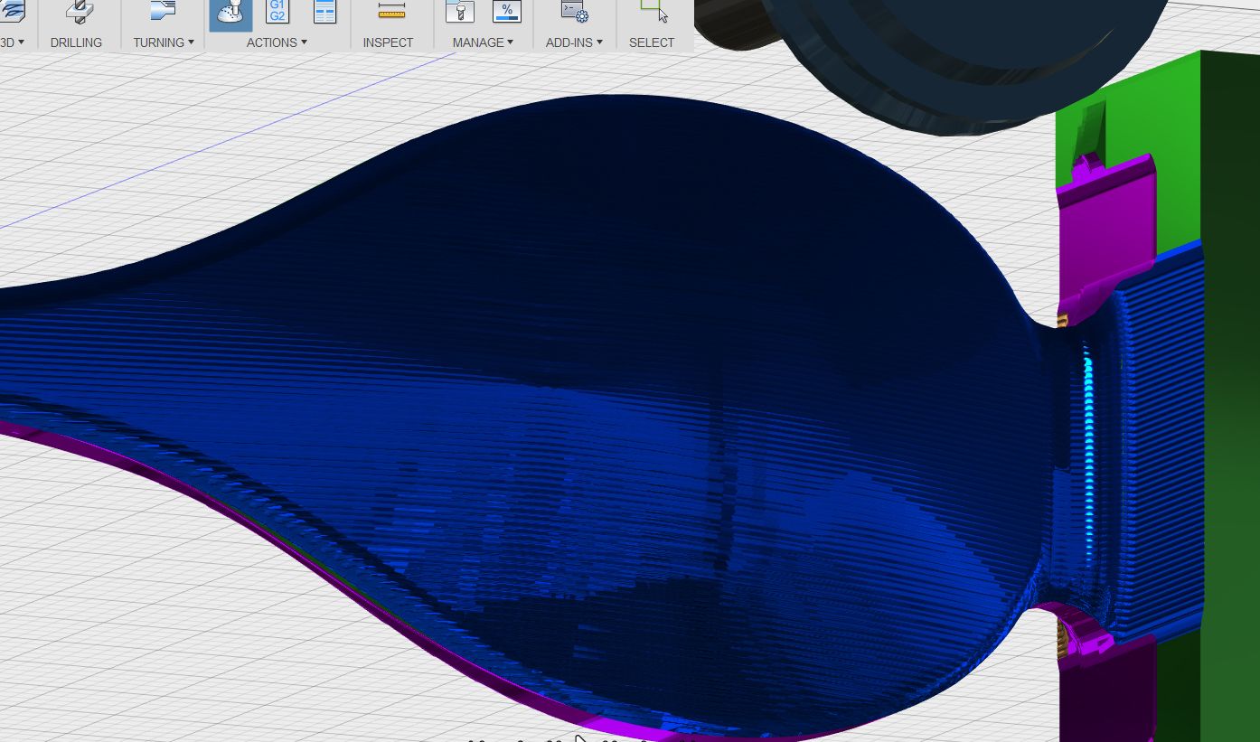

3) Click >| to skip to the final CNC machined part.
4) Inspect the model.
This is what the part will look like after all machining operations. Zoom in to make sure all areas look the way you expect.
