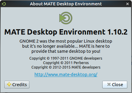

1. Ubuntu Mate Desktop 1.10.2 is the OS version.
