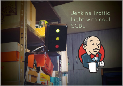

Step 6: List of HW Materials
What you will need...
- plastic electric box (Shop in EU)
- DC converter from 12V DC to 5V DC (From ebay)
- 4 relay module (from ebay)
- 3 big leds buy in local radio-shack shop
- 3 resistors
- Cables for arduino wiring
- DC 3.5 female plug
- 12V DC power suplly
- PCB stands get from ebay (somethinglike this from ebay)
Step 7: Build Traffic Light
Sorry I don't have video how I build traffic light but it is not that hard jut drill few holes a put everything together.
I will provide later completely schematic for wiring inside the box if somebody wants email me (adamluptakosice@gmail.com).
Before
Before you build the whole thing, Test first :) TDD in action, buy relay module with Led signalization. I used tutorial from this site and connection everything works for the first time :) http://antonfisher.com/posts/2016/01/05/make-rasp...
So If you follow tutorial in the link you will have working jenkis Traffic light is not that hard just make every connection properly.
Try to add some test project Like I add put there sleep echo etc. a try if its flasing check my video.
