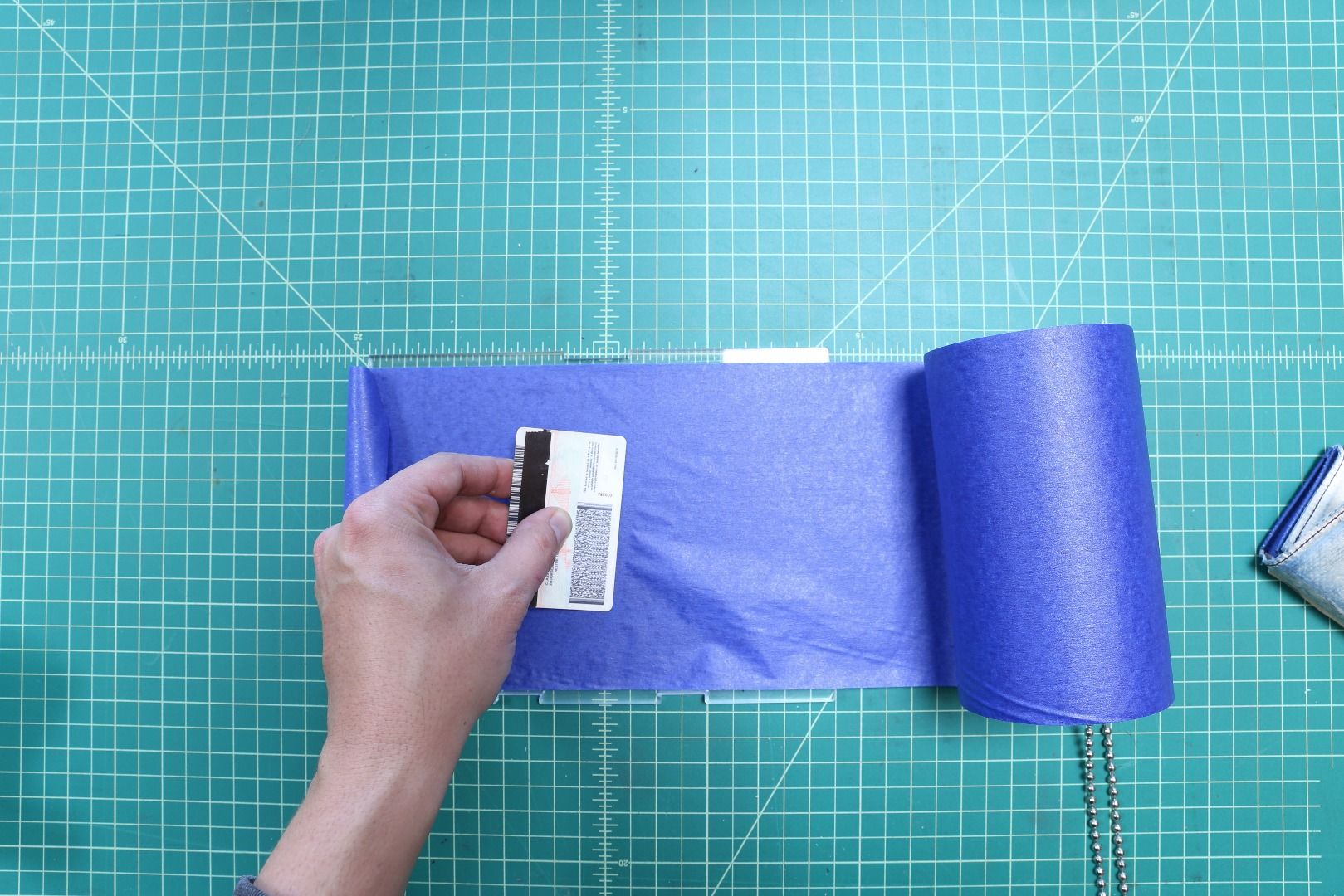

You can use 3M ScotchBlue 2090 Painter's Tape as a build surface because it's large enough to cover the whole bed.
Apply the Tape: The first step is to line up the tape on the bed so that it doesn't cover up the slots for the build platform's clips. It's really important to smooth out the tape so there are no bubbles. I've found that my driver's license is the best tool for this job.
Sand with 220 Grit Sandpaper: This removes the slippery finish on the tape, allowing the filament to stick to the bed easily. You can also use a specially made Build Platform Tape and skip the sanding step. I used the key knife from my keychain (on the right) to get a clean cut on the edge of the tape.
Wipe Down with Isopropyl Alcohol: This removes the dust leftover from sanding and any oil from your fingers that might still be on the tape. Be careful not to touch the tape once you've wiped it down- getting oil from your fingers on it would defeat the purpose!

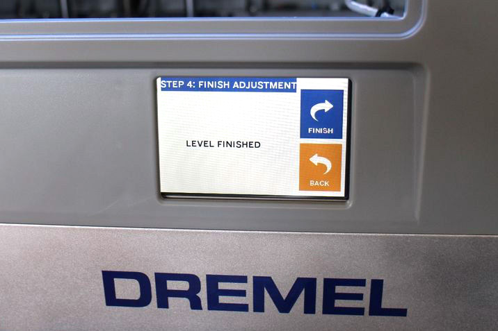

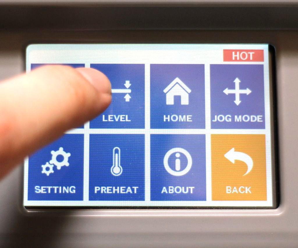

For lots of FDM printers, including the Dremel 3D Idea Builder, the build platform must be level for prints to build properly. I've found that with near-constant use, I only had to level the platform once in three weeks. If the filament doesn't seem to be sticking to the bed at the very beginning of a print, there's a good chance the build platform isn't level.
The instructions on the touch screen are pretty straightforward. Basically, you just put a piece of paper between the nozzle and the bed and adjust the screws until the gap feels just right. The paper should easily slide in and out in the gap while having a very small amount of friction.

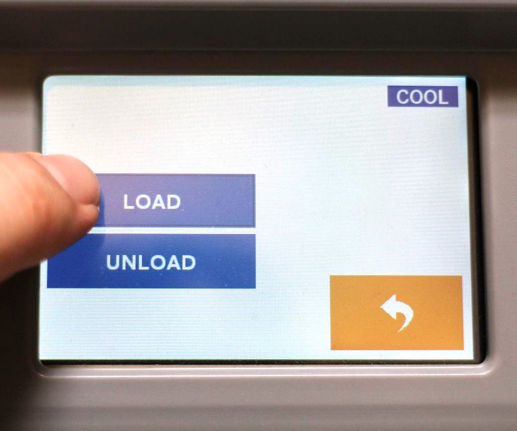

LOAD
To load filament, just follow the directions on the screen again. The motor will run automatically for a few seconds to load the filament into the extruder. Check the nozzle and make sure a little filament has come out before printing. You may need to go through the load process again to make sure it's totally full. If the extruder isn't full when a print starts, it's possible that filament won't come out at the very beginning of a print, which can cause problems with your print down the line.
UNLOAD
You'll need to unload filament when you want to switch to a new spool.To unload the filament on the Dremel, just follow the menu. It'll heat up the extruder if it isn't already preheated, then ask you to press the extruder intake spring and pull the filament out.
PRO TIP: To avoid filament jamming, push the filament in for about half a second, then pull it out. I've found that this clears the extruder of any leftover filament blobs, which can create jams if you let the extruder cool down again before loading more filament.

Preheating is a good way to ensure that the extruder is warmed up and ready to go. I had the best results by preheating the machine for about 5 minutes, then loading the file.
Loading a file to print is really easy with this machine because the touch screen gives you a preview of the model! Just pop in the SD card, select the model from the list, and tap Build.

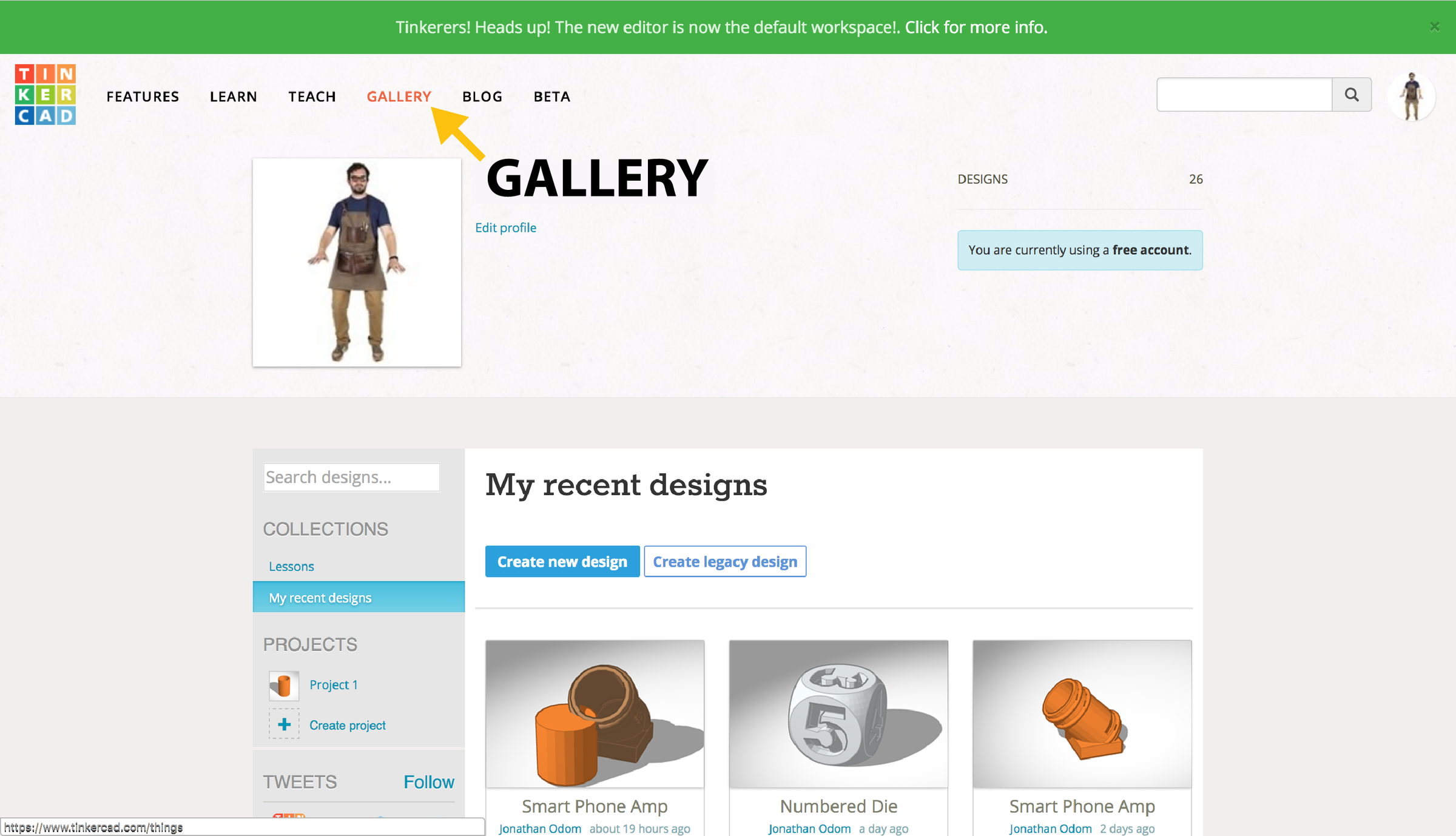

If you're into Minecraft, hopefully you've already taken Penolopy Bulnick's Minecraft Class. She goes into a lot of detail about how to get TinkerCAD models into Minecraft, but I'll give you a quick overview of the process here.

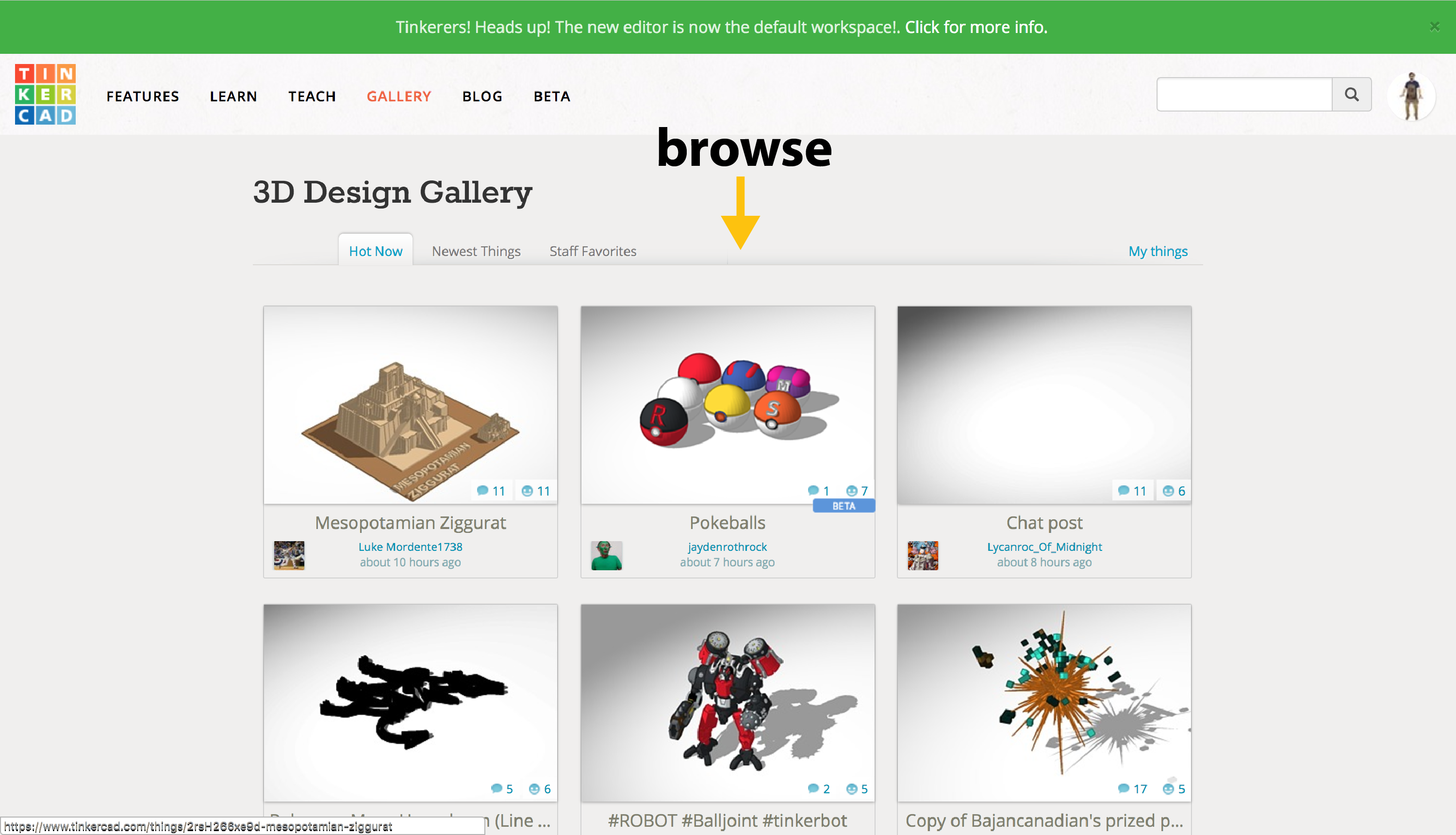

On the main TinkerCAD page, click on the GALLERY to find a cool model to try out.
You can browse by Hot Now, Newest Models, or Staff Favorites which is where I found the Mesopotamian Ziggurat model by LukeMordente1738.

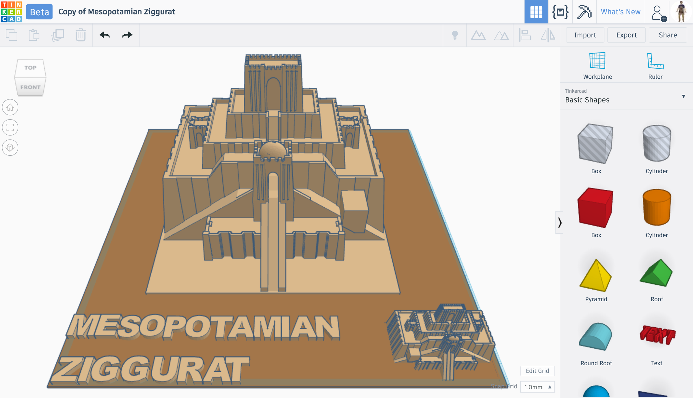

Click Copy & Tinker to create your own copy of the model and save it in your own project.

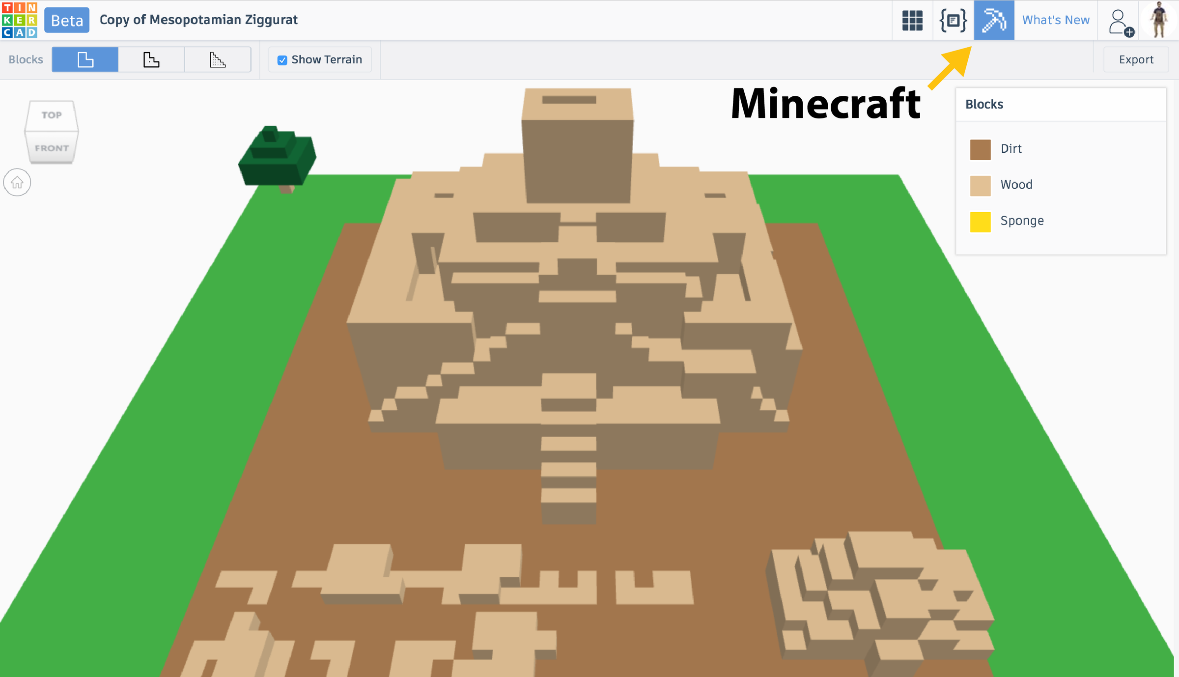

When you bring a model in, it's as if you made it yourself. You can add, subtract, ungroup, or delete parts you don't want as you please.

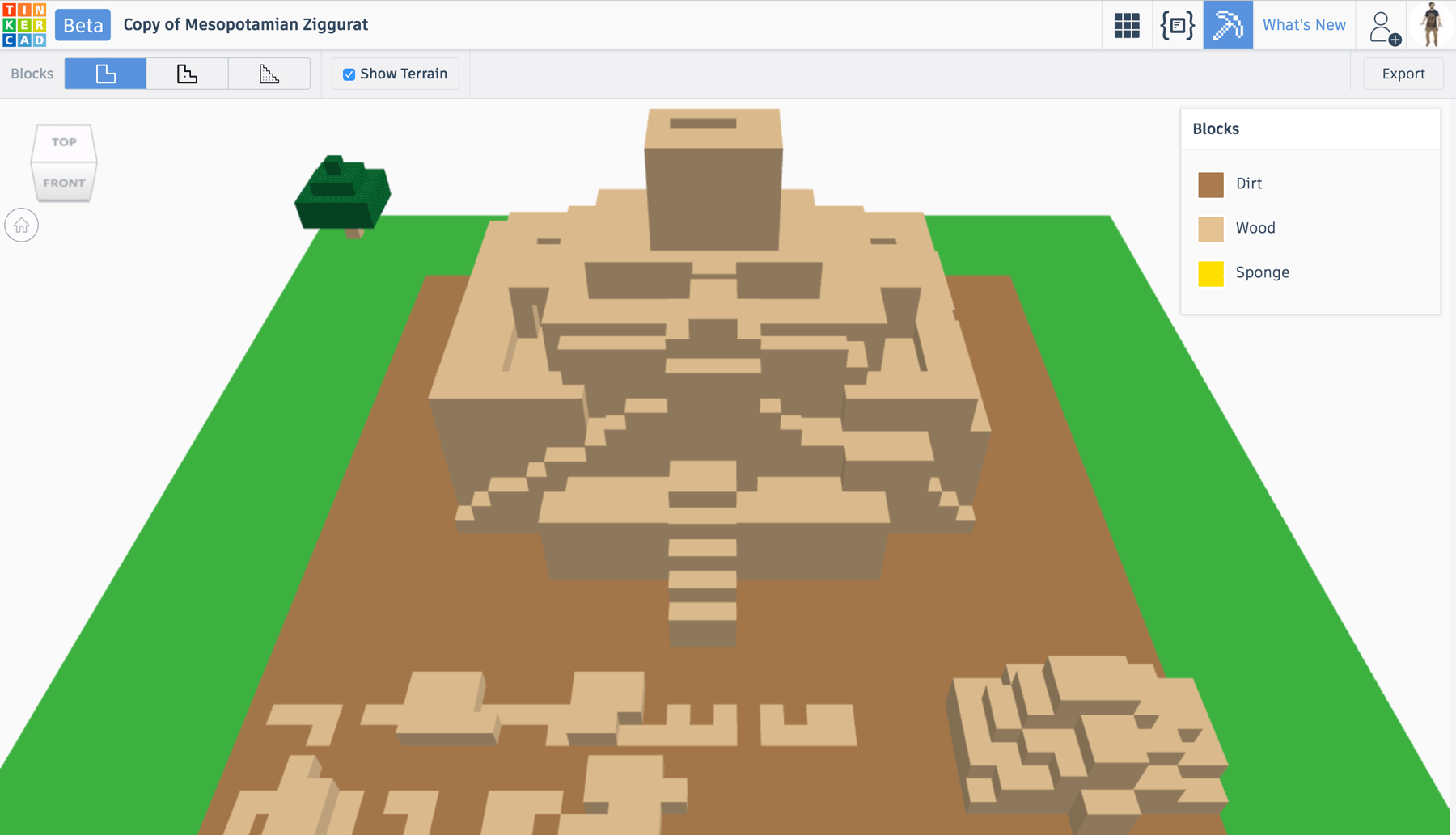

Click the Minecraft icon in the upper right corner, and you'll get a preview of what the model will look like if you bring it into Minecraft.
Click the Block Size buttons on the upper left to cycle through different resolutions.
When you've decided on a block size, just click the Export button to get a file you can import to Minecraft. Remember, the Minecraft Classhas lots of detailed information on this process, so be sure to sign up for it!
