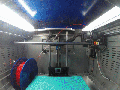

Step 7: Preheat and Print
Preheating is a good way to ensure that the extruder is warmed up and ready to go. I had the best results by preheating the machine for about 5 minutes, then loading the file.
Loading a file to print is really easy with this machine because the touch screen gives you a preview of the model! Just pop in the SD card, select the model from the list, and tap Build.
NOTE: Files may FAIL if they're not in the MAIN DIRECTORY of the SD card. I found that using sub-folders on an SD card made about half of the files fail, so be sure to keep everything in the main directory.

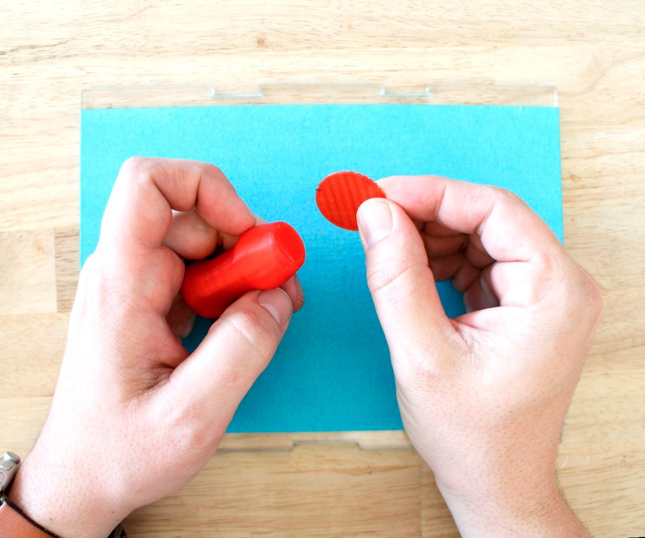

Step 8: Removal and Cleanup
With the print finished, all we have to do is remove it from the platform and we're done. This part is small and has no support structures, so it's easy to remove- just wiggle it until it pops off, then peel the raft off of the bottom of the part.
When things get more complex with larger rafts and support structures, sometimes a plastic spatula is necessary to get the part off of the bed, and sometimes support structures leave remnants on the part surfaces.
Believe it or not, I found the best tool for scraping the support structures off of the models was the can opener on my Leatherman Multitool. It's not sharp enough to cut you if you slip and poke yourself, and the pointy end is great for digging into the little crevasses, which will be necessary if you've printed a complex object that needs support structures in order to print properly.
