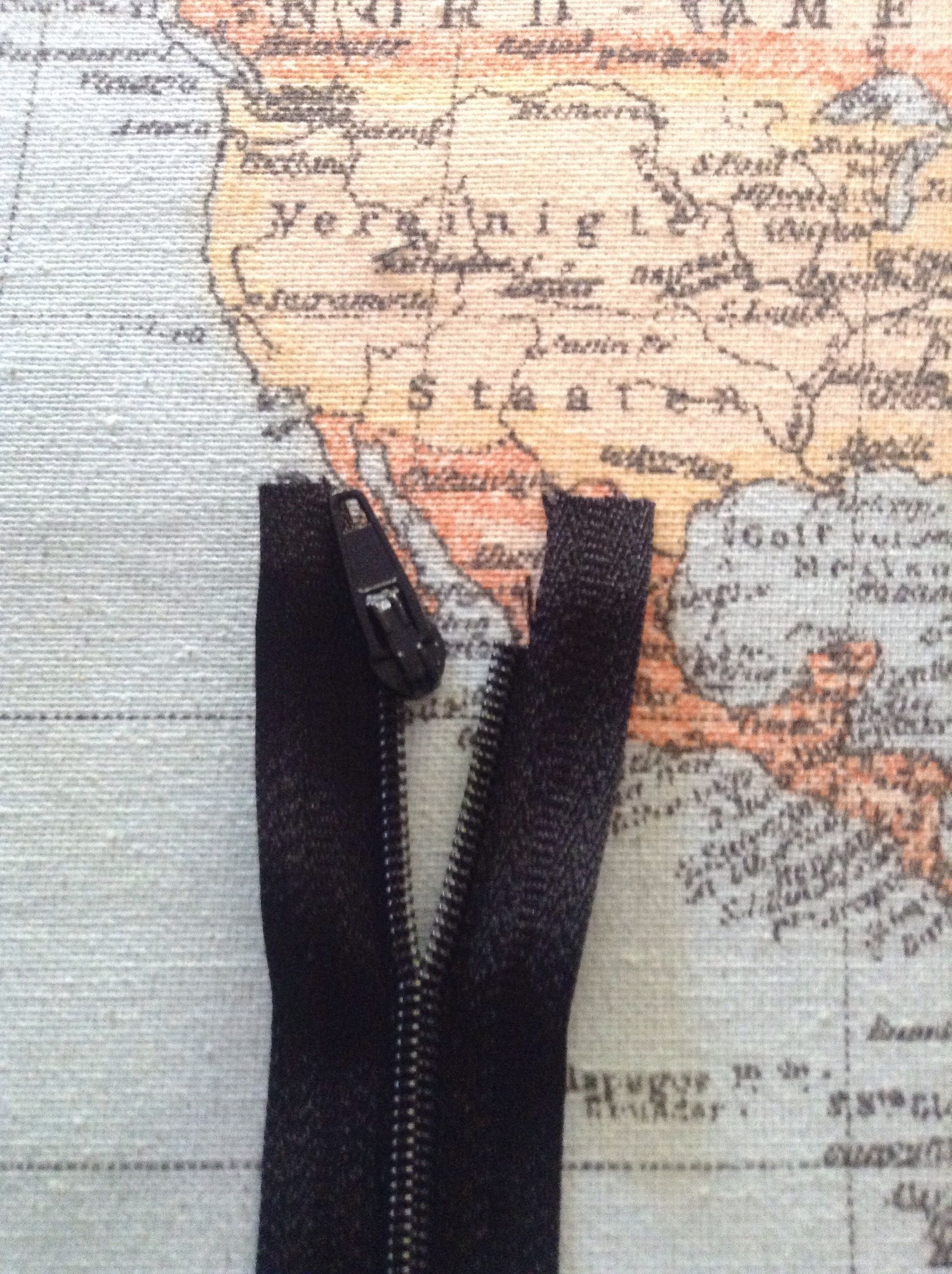

Step 3: Pin & Tack Zip on Right Side.
(While you're at this side, it could be a good time to prepare the zip shield & sew it all up together now rather than later)
