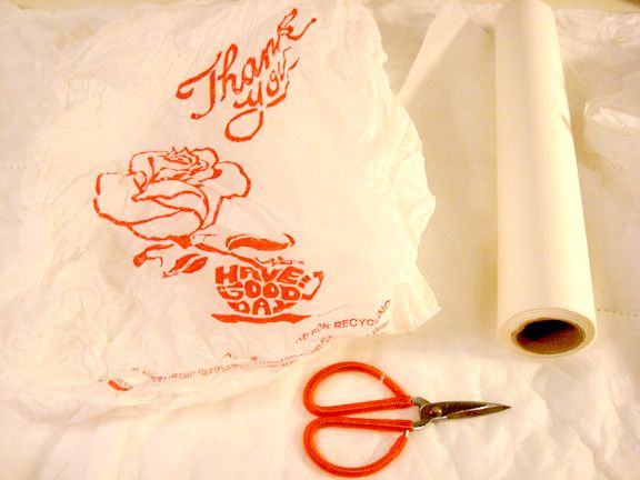

MATERIALS
fabric base. new, used, or fused recycled plastic fabric from our technique on Instructables !
