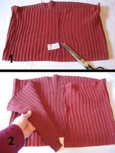

Step 2: Harvesting the Scarf Fabric
First, you'll need to remove a sizeable chunk of the sweater for use in making this scarf, so we will now proceed with the extraction.
If your sweater is made of a knitted or crocheted fabric, you'll want to sew a line of stitching right around the body of the garment, just below the armpits, to prevent fraying when working with the pieces later on.
Once this is done, cut through the body of sweater, one layer at a time, ABOVE the stitching, to remove the desired piece.

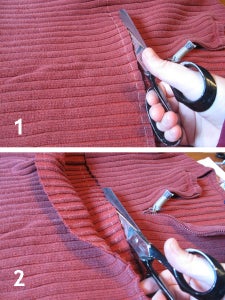

Finally, to make the piece workable, find one of the side seams on the sweater body and cut right along side of it, from top to bottom. You should now have one long piece of sweater with one seam in the middle of it, the remaining side seam from the old sweater.

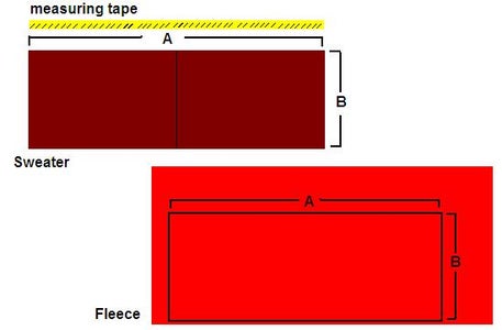

Step 3: Preparing the Lining
In order to make this scarf extra warm, we are going to add a soft fleece lining.

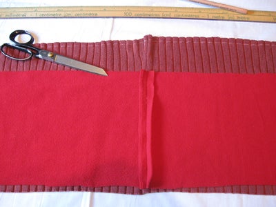

Using the measuring tape or yard stick, measure the length of the sweater piece you extracted in the previous step, and transfer that length measurement to the piece of fleece. Next, measure the width of your sweater piece, and transfer that measurement to the fleece.

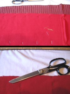

Cut out the resulting rectangle of fleece, and lay it over the sweater piece, right sides of the fabric together.
Pin the two layers of fabric together along the 2 long edges, and one end. The other end needs to be left open to turn the scarf inside out.
Trim any rough or uneven edges, either on the sweater or the fleece, in order to obtain the size of scarf that you want. A good width for the scarf is about 8", and the length is however long the sweater piece is.

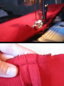

Step 4: Stitching Layers Together
Now that you have your sweater and fleece lining pinned, right sides together, sew the two layers together.
Follow a 1/2-inch seam allowance while stitching down one long side, across the end, and up the second long side, leaving the second end open to turn the scarf inside out. To ensure that the sweater doesn't fray along the cut edges, sew a zigzag stitch along the outer edge of the 3 sides you just stitched.
Turn the scarf inside out.
