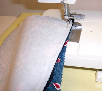

Arrange the bag's top with the underside fabrics facing each other. Use pins to hold the fabrics together. Start to sew from one of the short sides of the bag. You will need to leave about 10" unstitched length on one of the short sides so it is best to begin sewing about 2" from the corner and stitch all around the bag until you get to the last corner. At this corner stitch about 2" past the corner thus leaving about a 10" unstitched portion. You can view the complete stitch on the image below. Don't forget to remove the pins.
