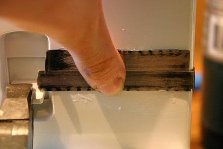

- Roughen the place where you will glue the metal bits with a bit of coarse sandpaper.
- Clamp a vice-grips, or similar heavy pair of pliers, to the toggle switch, to hold it in the "down" position.
- "Tack" the bolt in the position you want it to be to hold the toggle switch down, using a wee bit of hot glue.

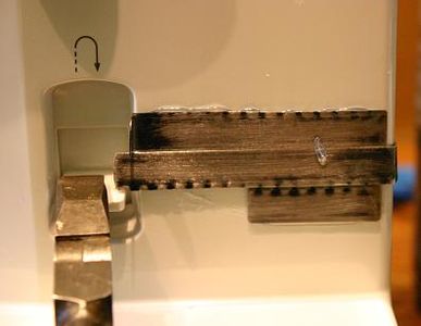

- Holding the top restraint with a pair of narrow pliers, warm it up using the propane torch, apply some hot glue along its length, and glue it adjacent to the bolt, in the position shown.
- Warm up the bottom restrain, apply glue, and glue it adjacent to the bolt. Note the caption on the picture - I screwed up a bit in the assembly. It's ok, though...
- Warm up the hold-down ties, apply glue, and glue them over the bolt. Make sure they are far enough back from the toggle switch that the bolt can flex out of the way of said toggle switch.
- Pull or push on the bolt to free it from its hot glue tacks.
- Warming up only as many of these glue joints at once as is required, shift everything as required, to make the operation tight yet smooth.

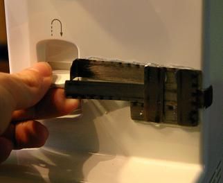

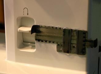

Step 3: Use
With the bolt in the active position, you can lift it out of the way to easily switch between forwards and backwards with a single hand (but, admittedly, two or three fingers).
Or, you can slide the bolt out of the way and use the momentary switch as Singer intended.
