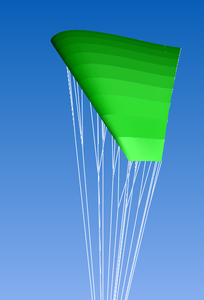

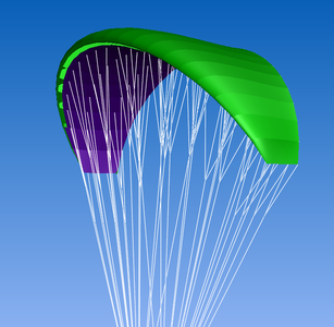

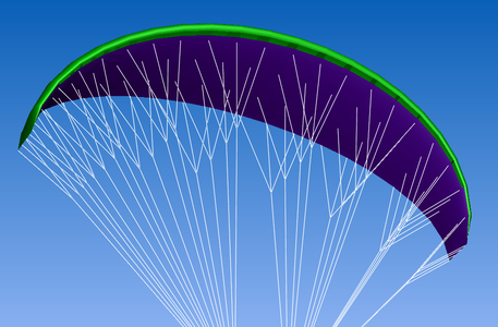

This does not go into how to design the wing. It assumes that you've already used something like SurfPlan (http://www.surfplan.com.au/sp/) to design you wing.

I exported my design out from Surfplan, and printed it on normal 8.5x11" paper. I then taped all the edges together. Make sure your paper is feeding into your printer the same way every time, so that the patterns on each page stay registered. You may have to adjust the alignment of the pages as you tape them together.

My paraglider design as two cascades of lines. First I attached the first cascade lines to the wing, then made the second cascade lines and attached them to groups of the first lines.
