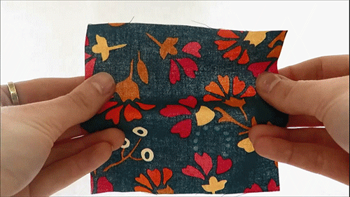

Step 2: Choosing a Fabric: Woven Fabrics
There are two main fabric types: Woven and knit

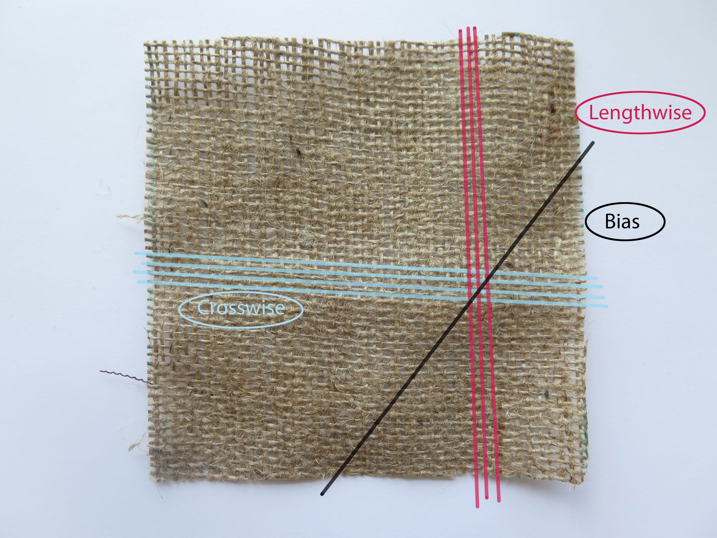

Like the name suggests, woven fabrics are comprised of tiny woven threads.

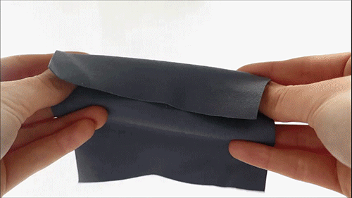

Woven fabrics can be identified by either examining their structure for lengthwise and crosswise threads or (if the structure is too fine) they can be identified by testing for fabric grain by stretching the fabric.
Identifying the grain of a fabric is important because it can effect the structure of your final product especially in more complicated projects such as apparel. You will need to know the grain direction of your fabric in order to properly orient your sewing pattern.
For now, identifying the grain of your fabric it is just a good habit to get into.

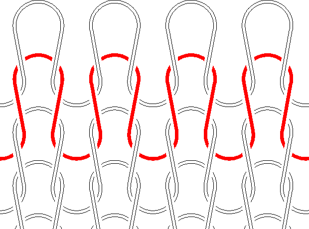

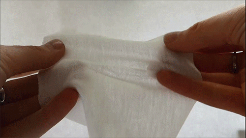

Step 3: Choosing a Fabric: Knit Fabrics
Knit fabrics are created by interlocking loops in a thread. Different loops can be used to create different fabric surfaces and textures.
Due to their structure, knit fabrics are usually softer and stretchier than woven fabrics.
There are two kinds of knit fabric stretches: 2-way stretch and 4-way stretch.
Because knit fabrics are so stretchy and tend to curl they can be less cooperative and more difficult to work with.
