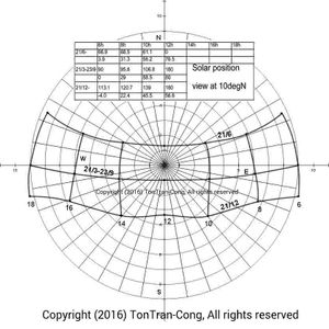

Figure: A typical graph of Solar path. This particular graph is made for 10 degrees North, for use in Saigon (around Tan Son Nhat International Airport).
The graph of Solar paths is a circular disc with concentric circles and radial lines bearing division marks to represent the elevation and azimuth angles of the Sun at different times of principal days.
The perimeter circle of the graph is graduated into 360 degrees to show the azimuth angle of the Sun from True North. It can also be used as a protractor for measuring angles. The concentric circles are the constant elevation circles.The radial lines are graduated 0 to 90 to show the angle from zenith to the Sun. The circle 90 degrees from the zenith represents the horizon in flat locations. The graduation can also be read from the horizon circle toward the center to show the elevation angle of the Sun.
All positions of the Sun at various time on an equinox day are plotted to make a Solar path for that day. The paths for the Sun on two solstice days are similarly plotted. The time for the each Solar position on a path is also given by time marks such as 6hr, 12hr and 18hr.
It is assumed here that the Sun attains its highest elevation at noon of local time everyday (the duration of the day is therefore slightly longer or shorter than 24hr, to discount any effect from the Equation of time).

Be certain that the graph is for your current latitude! If it is printed on a map, it is for the latitude of that area.
The following steps show how to use the graph on an equinox day:
1/- Point your index to the Sun.
2/- Point your middle finger horizontally.
3/- Hold still the two fingers and measure the angle between them by placing those fingers along two radial lines of the Graph of Solar paths. Read the value of the angle. It is called the elevation angle of the Sun.
4/- Follow the Solar path for that day on the graph to its 2 points having that elevation value. The two intersection points give two times (one before and one after noon) and two positions of the Sun.
5/- Choose the one of those two points fitting your half day (either before or after noon-time).
6/- Lay the graph of Solar path horizontally. Rotate the graph until the line from the graph center to the chosen intersection point goes beneath the Sun.
7- The 0 degree azimuth line of the graph is now aligned along the direction of the true terrestrial North.

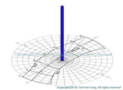

Step 5: Application 1: Shadow Stick Navigation for Vehicles.
You can print your graph on a disc for use in your vehicle. You can use only one single disc if the vehicle does not travel more than 5 degrees = 300 nautical miles = 555km in latitude from your base.
Lay the rotatable disc horizontally with a vertical stick at its center. When the shaddow of the stick is on the opposite side of the chosen point on the graph, the line of 0 degree points exactly at True North. This method of Solar navigation only needs the graph and a vertical stick and is immune to vehicle shocks and stray magnetism.
This method needs the above device and is less general than my method given in reference [1] but may be easier for users to comprehend.

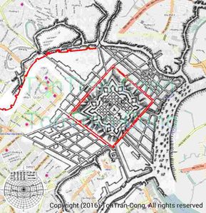

Step 6: Application 2: As a North Direction Marker
Figure: Map of an old citadel overlaid on a modern satellite based map. The graph of Solar paths is given on bottom left corner instead of the compass rose.
The illustration is the map of an old citadel overlaid on a modern satellite based map. The graph of Solar paths is given on bottom left corner instead of the compass rose. The graph of Solar paths gives more useful information than a compass rose occupying same area.
Notes on my composite map: The modern map data are used under Open License from Open Street Map, the data are owned by Open Street Map Contributors. The old area has adjusted and selected data from a 150 year old map with expired Copyright.
