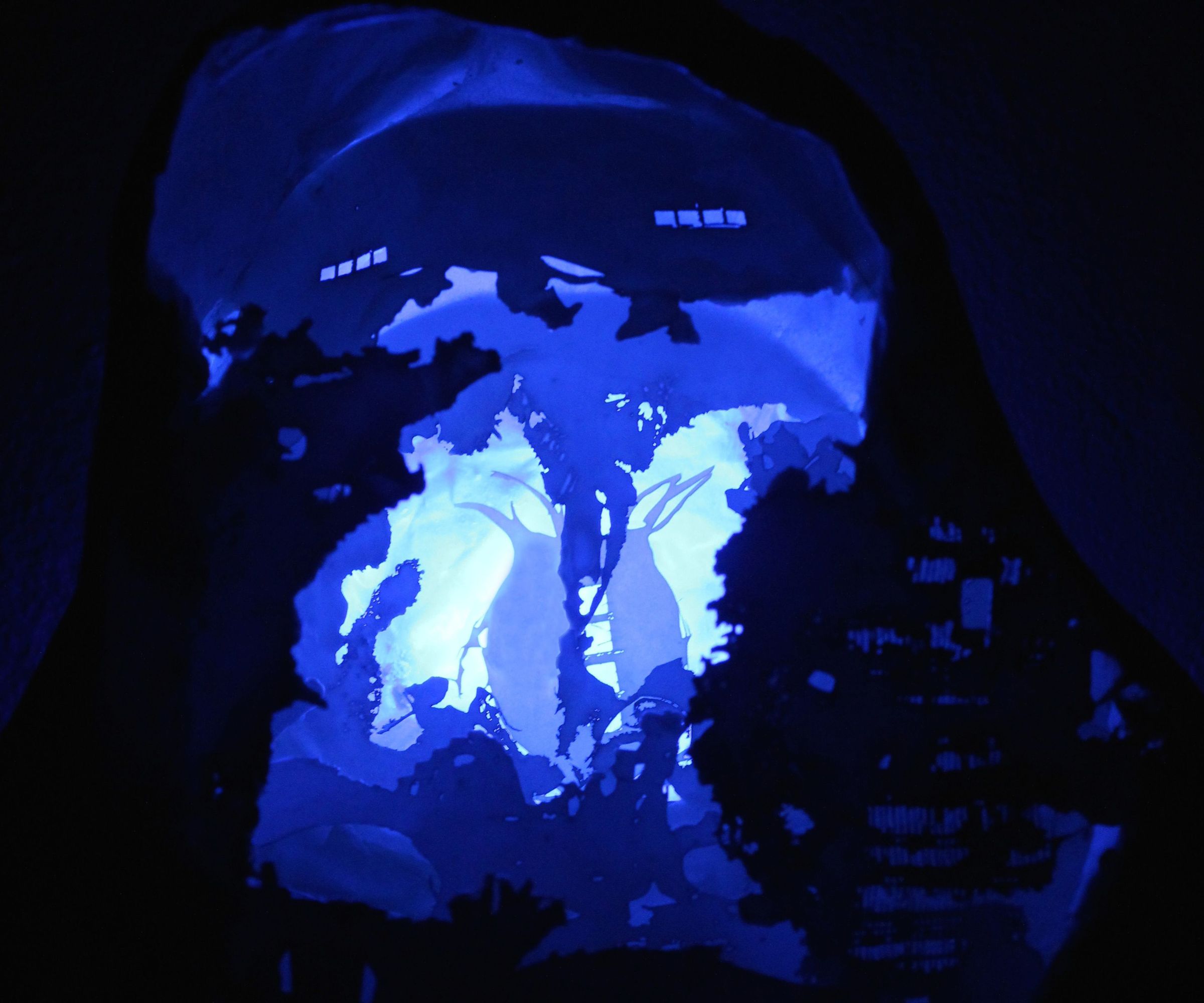

Introduction: Shadow Pod: Nightlight
This shadowpod is the product of a long process of
experimentation with composition, light, and materials. After playing with fibrous material, foam, plumbing material, found objects, and wire skeletons, I came to the conclusion that pretty basic paper mache methodology was the best way to create a hollow volume (pod) for this particular project. The pod encapsulates an industrial landscape smashed with organic utopia, backlit in blue. It represents a window into an imaginary place. Originally, this piece was not made with any function in mind, but I think that it could function as an intriguing nightlight.

Step 8: Joining the Interior With the Exterior
You will need: more glue ( for this step I prefer tacky glue over Elmer's because it is thicker and dries more quickly)
Make sure the edges of your cut outs match the contour of the inside of the paper balloon form.
Note in hindsight:
Incorporating tabs into the design of your shapes in the Adobe phases would be a helpful step. This would require more compositional planning ahead and less spontaneity in the final arrangement.
Add tabs to your paper cut ours and attach them to the interior of your pod shell. Fold these away from the opening of the piece, so that when you look into the piece, they are hidden from view. Glue in place (using tacky glue), and then (optional) use tiny pieces of tracing paper coated with Elmer's glue to integrate them into the surface of the paper mache. (The pod shape is in the round, but intended to be viewed frontally.) Begin this process in the back of the object and work your way toward the entrance of the piece, where special attention should be paid to integrating edges.
