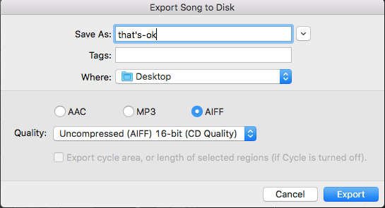

Step 4: Export File From QuickTime Player to Garage Band
Once you have the recording saved in the desktop like the screenshot above, you will simply drag the file into GarageBand to export this into Uncompressed 16-bit AIFF file. This can be done by clicking the Share button --> Export Song to Disk as shown in the third picture. Then, click 'AIFF' and '16-bit CD' and save it into desktop again.
