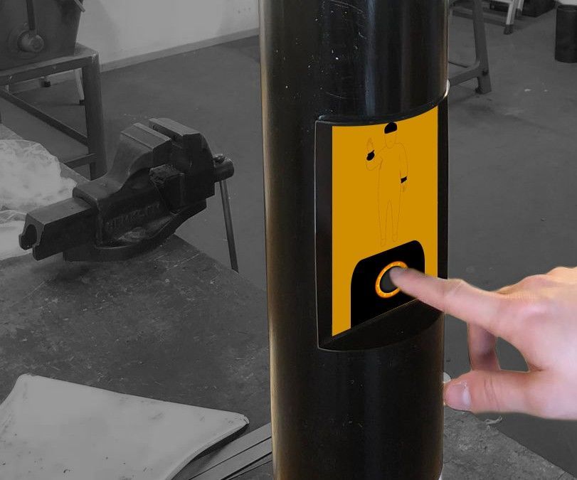

Introduction: Shake Gesture Controlled Lamp Using Arduino
Intro
Ever wanted your own lamp that can be controlled by a shake gesture using your smartphone? Here is a simple guide on how to create your own Shake Gesture Controlled Lamp an Arduino.
