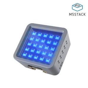

Introduction: Shake the Dice Using Atom Matrix ESP32
In this Tutorial we are going to make an Electronic Dice that will display a different number every time you shake the Atom Matrix ESP32. The project is based on a built-in accelerometer where we detect the force of the movement.

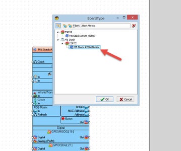

Start Visuino as shown in the first picture Click on the "Tools" button on the Arduino component (Picture 1) in Visuino When the dialog appears, select "Atom Matrix" as shown on Picture 2

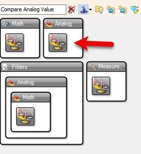

- Add "Compare Analog Value" component

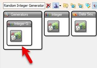

- Add "Random Integer Generator" component

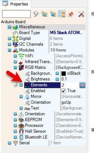

- Select "M5 Stack ATOM Matrix" board and in the properties window expand "Modules">"RGB Matrix">"Elements" and click on the 3 dots button

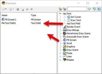

- In the "Elements" window drag "Fill Screen" to the left side

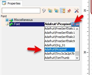

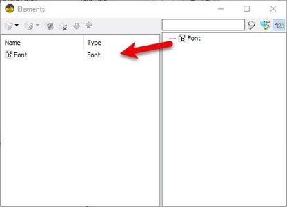

- In the "Elements" window drag "Text Field" to the left side, and in the properties window set "Color" to aclRed and "X" to 1, select "Elements" and click on the 3 dots button, In the "Elements" window drag "Font" to the left side and in the properties window set "Font" to Adafruit\Picopixel
- Close both "Elements" window

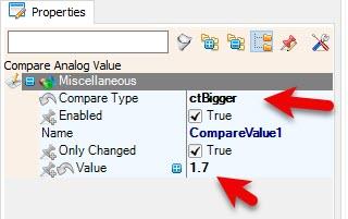

- Select "CompareValue1" and in the properties window set "Compare Type" to ctBigger and "Value" to 1.7

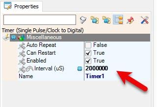

- Select "Timer1" and in the properties window set "Interval (uS)" to 2000000

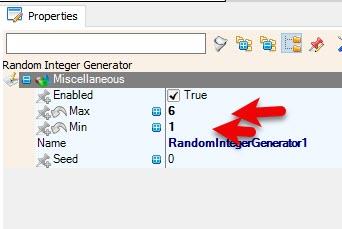

- Select "RandomIntegerGenerator1" and in the properties window set "Max" to 6 and "Min" to 1

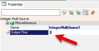

- Select "IntegerMultiSource1" and in the properties window set "Output Pins" to 3
