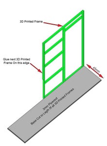

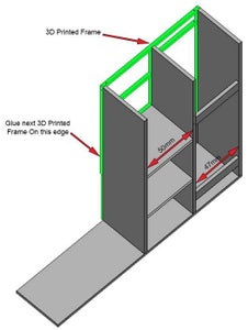

Pic 1. First the 3D the printed frames are glued together to form the complete run of units rear and side.
Do this on a flat surface with a timber guide to keep the rail aligned while the glue dries.
Pic 2. Is used as a referance for gluing.
Pic 3. Next cut a 45mm wide strip of wood to the total length of the lower frame rail.
Glue this length that will form the cabinet base to the lower frame rail.

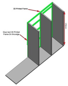

Now cut 45mm wide strips into 59.5mm lengths to form all the cabinet sides.
Glue the sides to the base plywood and 3D printed frame uprights.
Finally a 10mm high wooden baton is glued to the underside of the base.
This is set back from the front and rear of the base to form the kick rail at the front and wiring space at the rear.
Pic 4. A 3mm Plywood length around 30mm high is fitted at the inside rear of the Hob unit carcass. This is used to fix the side units to the side wall of the kitchen.
Pic 5. A corner post part name KitchenCnrPost is glued to the 3D printed frame where the doors meet at the corner.
3mm Plywood shelves can be added where required and should be cut around 43mm deep.

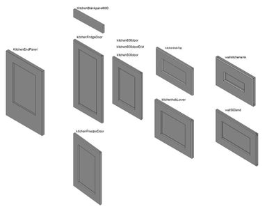

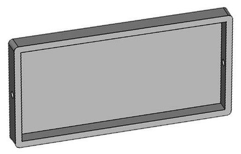

All the cabinet doors are 3D printed and have holes for metal rod hinges.
Pic 1. Door types with file names.
Pic 2. Door Locations with 3D file names.
Print out all the doors not forgetting the end panel.

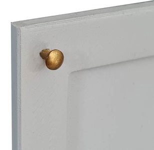

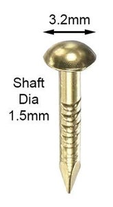

Pic 3/4. Fit the door knobs.
The kitchen cabinet door nobs were made from 8mm Round Head Brass Nails.
https://www.amazon.co.uk/dp/B078BPNV62?ref_=ppx_hzsearch_conn_dt_b_fed_asin_title_1

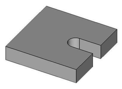

Pic 5. The knobs are fitted into 1mm holes in the cabinet doors using the "KitchCnrTemplate" to position the drill for the holes.

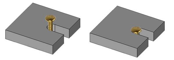

Pic 6/7. KitchenKnbSpacer
Push the brass pins through the hole in the door drilled above.
Slide the spacer under the brass pin until the head is flush with the top of the spacer.
This gives a 2mm gap. Pop a small bit of super glue on the rear of the pin where is passes through the back of the door.

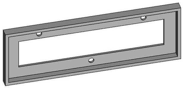

Cut the hole for my Hob if fitted, see this Instructable for details.

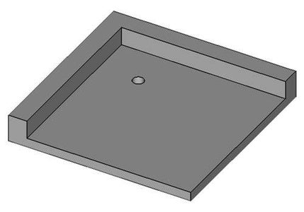

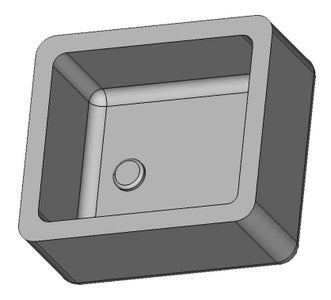

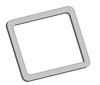

Pic 2. I have designed a sink for this kitchen. If you are using it cut a hole in the end worktop under the shrter wall units for the sink using the template in Pic. 3.
Pic. 3. Position this template on the worktop where the sink is going and then draw around the inside with a pencil.
Cut out the hole with a jigsaw.
