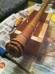

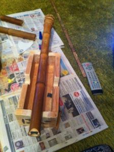

Things you'll need
small wodden box to hold the shakuhachi in place while working on it, (easy to manufacture yourself)
many many different kinds of files, very long hand drill bit, long file.
strong thread for binding (prevents cracks)
urushi laquer (toxic, but you can use normal boat laquer instead)
a piece of bone or similar, for the utaguchi (mouth piece)
Madake bamboo (I puchased mine , with a certificate of authentication from japan) approx. 200dollar

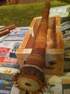

Step 1: Step One Beginning
cut the madake bamboo to proper length, since it was long ago I made mine. I have forgotten the mesurements.
start pruning the root, and filing it down.
Then drill with hand drill through all of the membranes inside, this will take long time, and after that file with file so the inside is
completly smooth
completly smooth

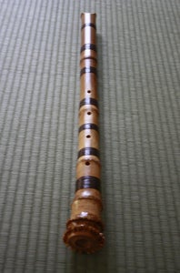

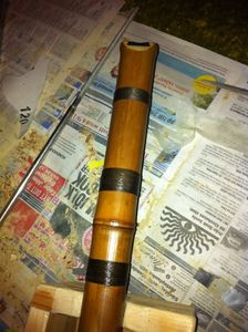

Step 3: Step 3 Binding
When it is "done" its time to bind it to prevent future cracks
I used traditional strong thread (cant remember its name) and I bound it on several places as seen on the picture,
take it very slowly here cus you don't want to mess up.
After the binding laquer it generously with urushi laquer especially the root part,, and the bore, and very lightly on the utaguchi, then laquer the bindings as well

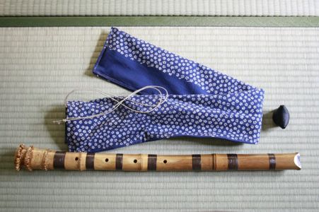

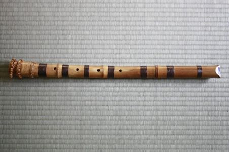

Step 4: Finished Product
Once your done you can sew a case and utaguchi protection cap like I did and it will be save for many years,
Happy playing :D
