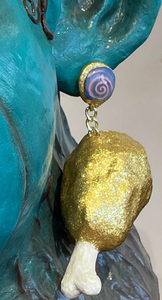

Step 5: Midas Meat
Her earrings are glittery golden chicken drumsticks, formed from twisted newspaper and masking tape. They were papered and painted just like the rest of her, but then given the fancy additional coating of gold glitter Mod Podge. To make the stones, I blooped a blob of hot glue over a black bead and let it dry. Then I painted a spiral on it, and blooped another blob of hot glue. Presto! Gaudy stones for costume jewelry for sasquatches!
