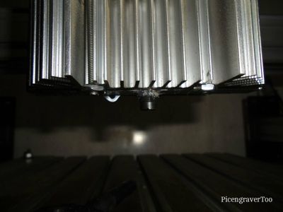

The Shapeoko 2 already comes with a spindle mount, so adding a Laser Diode is fairly easy by bolting it the spindle clamp tapped screw holes. The pictures are self explanatory, but others may want to do this different based on the diode they are going to use, or materials that they have access to. We had a piece of .500" (12.7mm) thick aluminum plate and a CPU heat sink that we bored the Laser Diode's 12mm (.4724") module's diameter size in-between them at a depth of the module's length. This way it's sandwiched between the two parts to hold it in place. A through hole was needed for the Laser Diode's wires to exit also. Some thermal paste between the Laser Diode's module and heat sink/aluminum plate is recommended.
A fan to blow smoke away, cool the heat sink and diode and to keep contaminates away from the lens is needed. We also screwed the Flexmod P3 laser driver's power MosFET down to the .500" (12.7mm) aluminum plate with thermal paste between them to act as a heat sink instead of the one that was supplied with it. The upper spindle clamp screw holes made a nice place to attach our junction wiring board. We also used these tapped holes for mounting the analog volt meter also.
The key dimensions here are to have the Laser Diodes lens approximately 2.75" (69.85mm) to 3.00" (76.2mm) from the table when the Z axis is all they way down and bottomed out. We made a .250" (6.35mm) aluminum plate that screws to the bottom of the Z axis MakerSlide that bottoms out on the Spindle Mounting Plate. This is for a reference when setting placement of the Laser Diode from the table surface, focusing the lens based on the table surface and moving the Laser Diode up from there to maintain the proper focal point on the material to be engraved.
If your Shapeoko has a homing switch for the Z axis, then this can be used for your referencing off from the table distance instead of the stop plate.

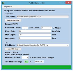

We generated the Wagner Laser engraving Gcode in PicLaser Lite, but we are going to add some enhancements to this engraving that our full featured software program PicEngrave Pro 4 + Laser has as an option when generating the Gcode. This option is called "Feed Rate Change".
Our best friend, John Champlain developed/invented this very unique Gcode process for engraving photos with Laser Intensity control and it has really made our "On-The-Fly" Laser Diode engravings stand out! A BIG Thank you goes out to John!!
We wrote the stand alone software program PicFRC that does the same "Feed Rate Change" by taking a gcode that has already been generated in PicLaser Lite and adds a variable feedrate to the end of each line of Gcode based on the Z axis minimum & maximum depths. Our program allows you to set a percentage of a full feedrate and varies it based on the depth range in the Gcode. It slows the feedrate down in darker areas when the laser power increases and speeds it up in lighter areas when the laser power decreases which allows us to expand the lighter and darker shade range. It really helps us fine tune our "Varied Intensity" Laser Diode photo engraving process even more.
On the Wagner Gcode we used a 60IPM feedrate with a 30% reduction at maximum depth. White shades [Z.0000] (inch or mm) will run at 60IPM (1524mm/m) and black shades [Z-.0255"] (Z-.65mm) will run at 42IPM (1066.8mm/m). All shades in-between will vary in the 60-42IPM (1524mm/m-1066.8mm/m) range based on the Z axis depths in the Gcode that controls the Intensity of the Laser Diode.

We used Gaussian Blur in Photo-Paint to smooth out the sharper edges slightly from the prior sharpening we did on the original image. I know this sounds confusing to sharpen then blur afterwards, but the original sharpening we did in PicEdit Lite brought out more detail to the original image which had very little to begin with. The Gaussian blur we did afterwards smoothed out this detail and sharp edges which made the varied power of the Laser Diode ramp in and out of the shade transition areas more smoothly.
In Step 9 we used PicLaser Lite with a Feed Rate of 60IPM (1524mm/m), minimum depth of Z.000 and a maximum depth of Z-.0255 (.65mm) with a 30% “Feed Rate Change“. In this test we want the absolute maximum power that is available out of our Laser Diode, so we used a maximum depth of Z-.031 (.787mm) instead this time.
A very good heat sink for the Laser Diode is needed for this process because running it at full power for long periods of time, could overheat the Laser Diode and damage it to the point it will fail. Our .500" (12.7mm) aluminum plate and CPU heat sink with fan combination effectively dissipated the heat away from the Laser Diode Module. We checked this with an infrared temp meter as it was engraving and it never exceeded 80 degrees Fahrenheit (26.66 Celsius).
The lower power zeroing point of the Z axis was at 500mv on the voltmeter. That was Z-.004 (Z-.101mm) jogged down from 0v on the voltmeter. These settings brought us up closer to the edge of the 5v to the modulation before the MA3 shaft encoder jumps back to 0v again which intern gives us the maximum power output at our full Z-.031 (Z-.787mm) depth setting. To expand the shades to the point blacks become depths of cut instead of 8bit shading, we used a 75% reduction of the Feed Rate in PicFRC.
The finished engraving came out with black charring on the wood where the black areas were in the image. To remove the charring we used our air compressor with 150PSI to blow out the loose burnt material. After we removed the charred wood, the full depth of cut was .05” (1.27mm) deep. The charring was caused by us not using an air assist nozzle like the Commercial CO2 engraving machines use. An air assist nozzle will blow the burnt material away as the Laser’s focused beam is cutting into the wood.
