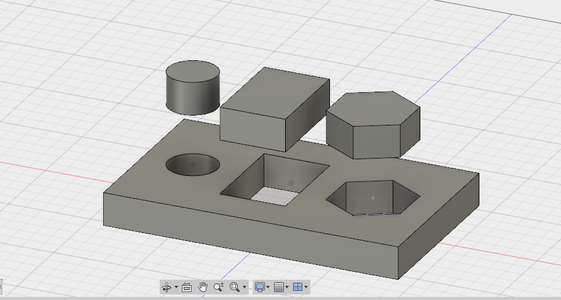

Step 1:
I have started building this puzzle with the help of fusion 360 which is
provided by autodesk.
First of all i have entered in the model work space of fusion 360.
Then I have drawn a rectangle .
I have set the dimensions in centimeters.
Step 2:
In this step i am in the model work space of fusion 360.
Then I have extruded the rectangle drawn in
previous step.
Step 3:
In this step I am in the model work space of fusion 360.
Then i have selected the upper surface of rectangle
to draw sketches of circle, rectangle and hexagon.
Then i have opted the stop sketch icon.
Step 4:
Then i have divided the drawn body along circle.
Then i have divided the drawn body along rectangle.
Then i have divided the drawn body along hexagon.
Now I have four bodies.
Then I have changed all four bodies to components.
Step 5:
In this step I am using the model work space of fusion 360.
Then I have moved the components vertically upwards.
Then i have applied sliding joint between the cylinder component
and the sketched circle.
Then i have applied sliding joint between the cuboidal component and
the sketched rectangle.
Then I have applied sliding joint between extruded hexagonal component and
the sketched hexagon.
Step 6:
In this step i have entered in the render work space of fusion 360.
Then I have changed the physical material from steel to
plastic.
Step 7:
In this step i am in the render work space of fusion 360.
In this step I have changed the appearance of shape puzzle.
I have applied red glossy color to the main body .
Then I have applied the yellow glossy color to the component
cylinder.
cuboid.
hexagonal extruded structure.
Step 8:
In this step I have entered in the animation work space of fusion 360.
Then I have exploded the three components one
by one.
Step 9:
In this step I have entered in the render work space of fusion 360.
In this step I have given different views of shapes puzzle for kids.
