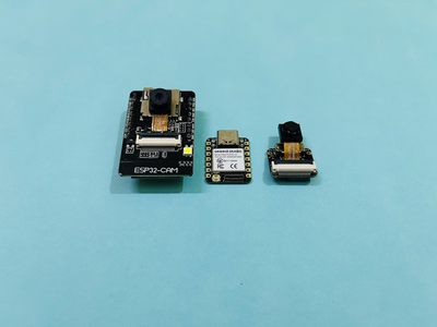

Whenever we have to use video output in any IoT or robotics project then Esp32-Cam module comes into mind. It is the one which can fulfil all the needs and has comparatively low price than other modules available. The good this is we can use SD card to store the video and images or we can stream to another device using Wi-Fi. There are some other options also you may try like integrating the module with blink IoT, cloud or telegram to get the data anywhere on internet. In this tutorial we will set up a server for Esp32 camera and then implement the same with telegram bot. Using server the access is limited within Wi-Fi range but with telegram we can get the images over internet.

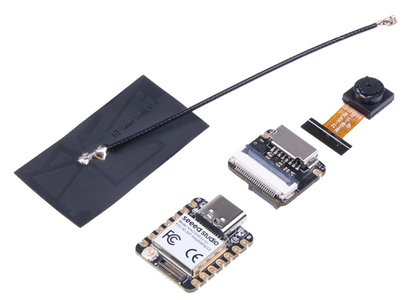

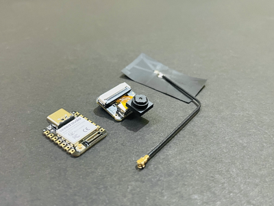

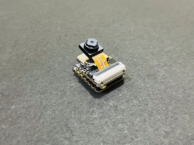

Step 2: Esp32 Sense:
Seeed Studio XIAO ESP32S3 Sense integrates a camera sensor, digital microphone, and SD card support. Combining embedded ML computing power and photography capability, this development board can be your great tool to get started with intelligent voice and vision AI. See more in the datasheet of ESP32S3.
· It has detachable OV2640 camera sensor for 1600*1200 resolution, compatible with OV5640 camera sensor.
· It supports programming in Arduino and Micro-Python.
· Support 2.4GHz Wi-Fi and BLE dual wireless communication, support 100m+ remote communication when connected with U.FL antenna
Features:
  • Xtensa LX7 dual-core,32-bit processor that operates at up to 240 MHZ
  • 2.4GHz Wi-Fi and low-power Bluetooth® BLE 5.0 dual-mode
  • 1x UART, 1x l2C, 1x l2S, 1x SPI, 11x GPIOs (PWM), 9xADC
  • On-chip 8M PSRAM & 8MB Flash
  • Onboard SD Card Slot, supporting 32GB FAT
  • Input voltage (Type-C): 5V
  • lnput voltage (BAT): 4.2V
  • Temperature range: -40°C ~65°C

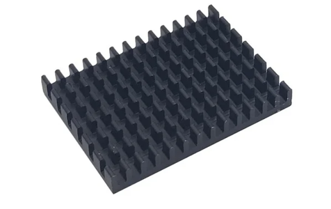

Step 4: Upgrade to ESP32s3:
This board has a very small form factor which is great but due to having overperforming CPU it dissipates a lot of heat. Which can be felt in the back side of module. Continuous video streaming may damage the CPU because of high power consumption (350mA) so it is suggested to add a small heatsink with insulated thermal pad on the back of side PCB.

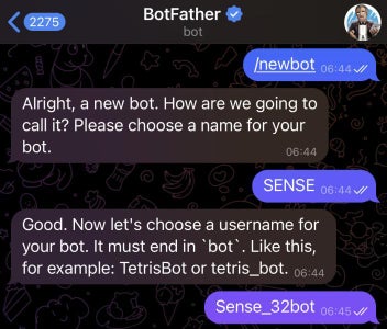

Step 5: Setting Up the Telegram Bot:
It is basically a bot making procedure. We have to make a bot which send command to ESP32 over internet and then we can demand for images over internet through commands.
Step1: Open the Telegram App and search for “BotFather” (https://t.me/BotFather) then send command as
1) Start the bot: /start
2) For new bot: /newbot
3) Name your bot, mine was as: SENSE
4) Give ID to Bot should be ending with bot, mine was as: Sense_32bot
This will generate an HTTP API key and a bot messenger link. API you can use in your code to implement telegram bot and through the bot messenger you can send the commands to ESP32S3_Sense.

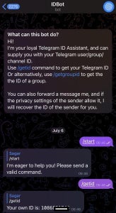

Step 6: Telegram Uploading Step2:
Step2: Get the ID of your Telegram using “IDBot” (https://t.me/myidbot) this id is unique to your account only. Send command as:
1) /start
2) /getid
This will give your telegram message ID which is used in the Arduino program later on. Here is the command line of my telegram bot I named as "Sense".

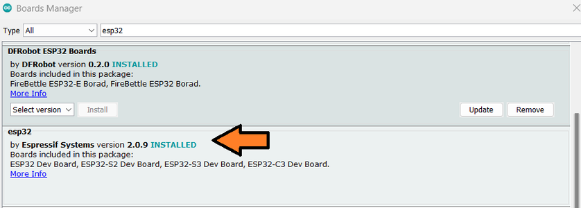

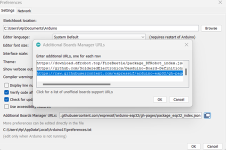

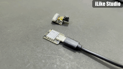

Step 8: How to Upload Code:

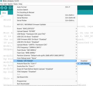

To upload the code first download the ESP32 board package in your Arduino IDE by adding The below given JSON file to the preferences under files menu. Then go to the board manager under tools menu and download the ESP32 boards. https://raw.githubusercontent.com/espressif/arduino-esp32/gh-pages/package_esp32_index.json
Choose the board as XIAO ESP32S3 and Enable the PSRAM before uploading.

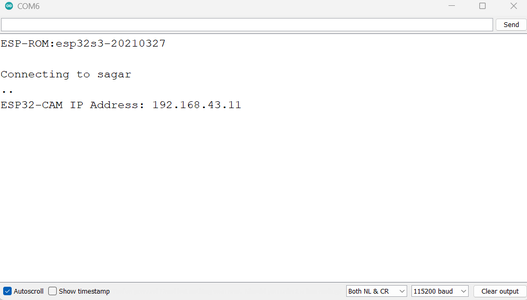

Choose the right COM port and hit upload. After uploading open the serial monitor you will get IP address for video stream over Wi-Fi client or you can command directly through telegram.

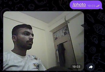

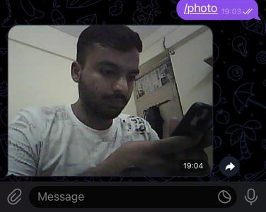

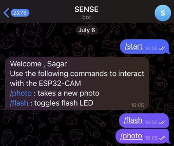

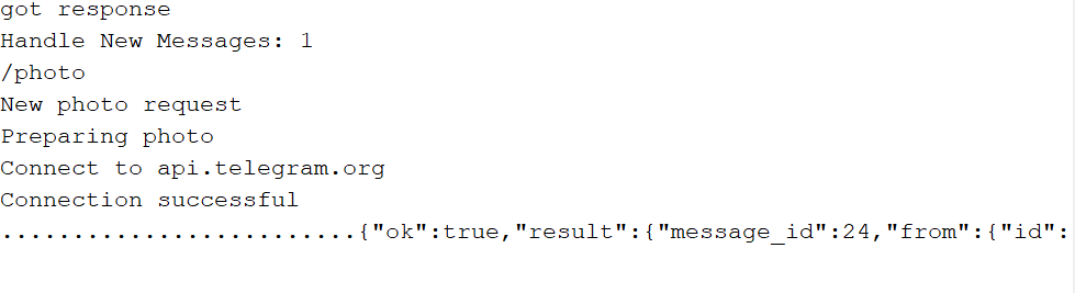

Step 9: Testing the Code:
After uploading when I started my own made telegram bot, I got two options one for Flash and other one for image. This small board don’t have any flash but you can use a LED on pin number 4 as mentioned in the program. The image quality is amazing with it’s 2MP camera sensor. Here are some image samples taken from the camera inside my room.
Images are shown here and Camera quality is quite good and it also has face recognition which can be implemented later on.
