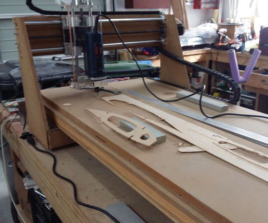

Step 2: Cutting the Kit
The Balsa cutting is a simple process it was done using a 1mm corn roll / fisheye cutter. These can be purchased on sites like AliExpress and Banggood for next to nothing and they really do a superb job. The Carbon Fiber sheet was cut using a 0.8mm cutter.
The cutting time will vary depending on your machine. Once the kit has been cut using a balsa knife cut the holding tabs and trim any parts should it be needed.
