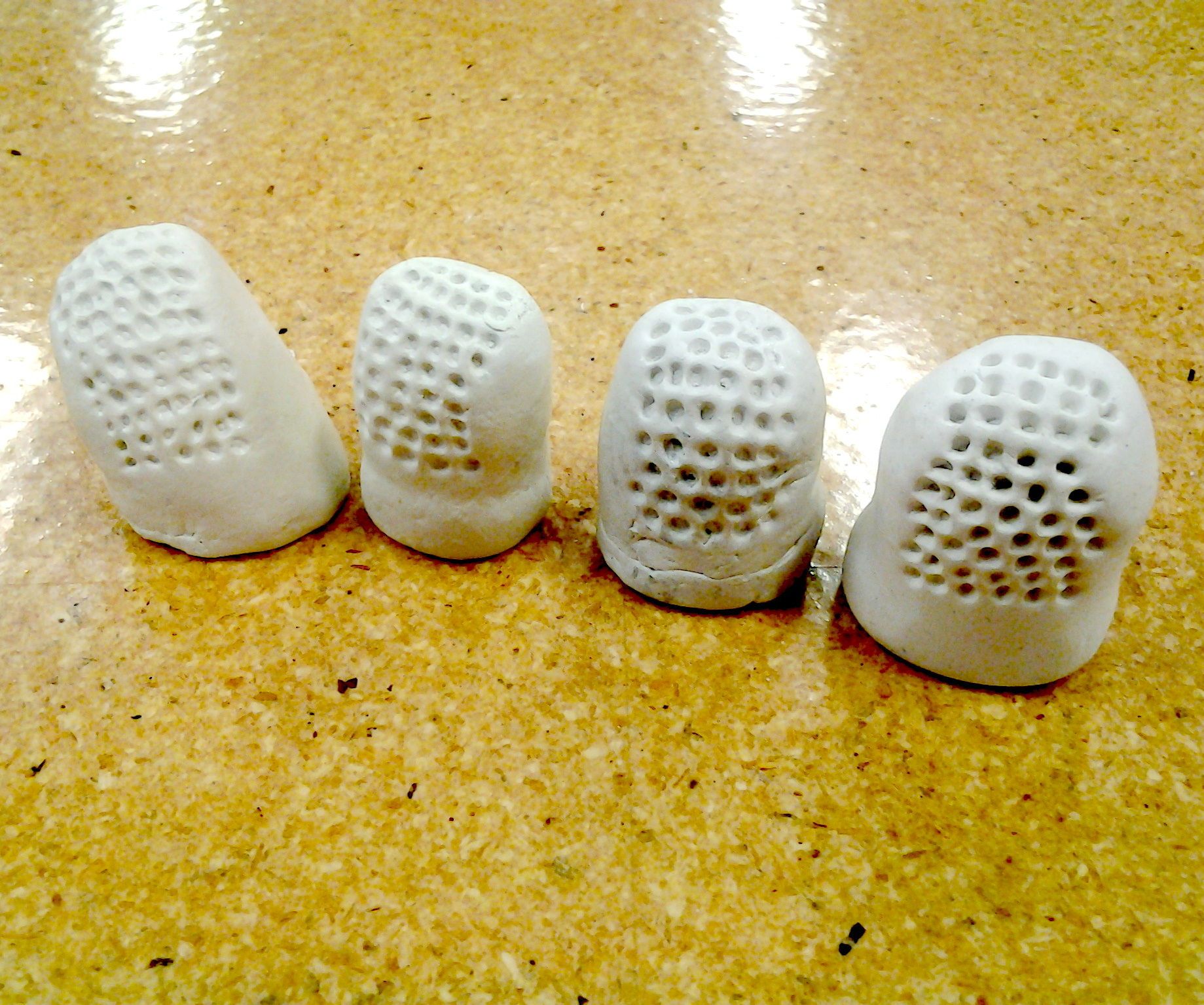

In the pictures I'm using Polymer clay to simulate expoxy putty, I forgot to take pictures when I was doing this project.

Step 3: Insert your sharp pointy object into the top until you've got it all the way in. Try to keep it as straight in the center of the straw and putty as you can. I kept a finger loosely at the bottom to give some resistance to the putty as it was coming back out. This way I'm sure I have a solid mass of putty inside the straw. Next, just wipe off the extra from the bottom. The extra that I had, I put on the top of the putty container as you can see the green stuff on the top of the jar.
